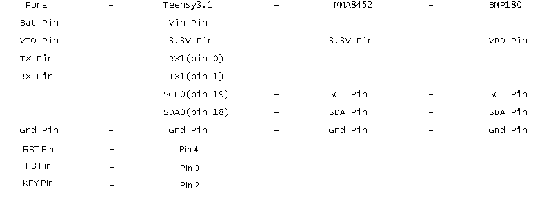

Step 2: Connections
Wire them up accordingly (Photo)

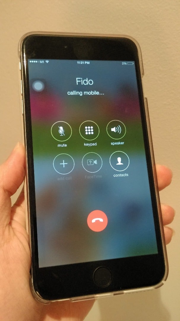

Step 5: ECollar in Operation

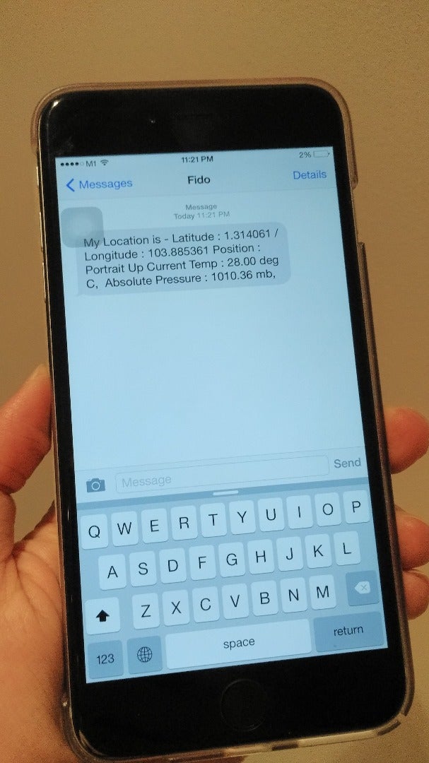

You can see from the photos, a call was initiated to the eCollar and within secs, a SMS with the following info were received.
Latitude
Longtitude
Accelerometer Position with X/Y/Z info
Absolute Pressure and Temperature
The Lat and Long info can be input to the URL below to get the actual point on map -
http://itouchmap.com/latlong.html
