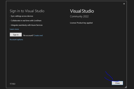

Step 1: Installing Visual Studio Community
Please use the link provided and download the visual studio community installer.
Upon opening the installer please press modify and select the c++ development.
After which you can install visual studio
Might take some time ;)

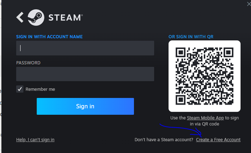

Step 2: Downloading Steam and 'installing' Mw2
Please use the link provided to install the steam installer and run it.
Once it's complete create a steam account (free)

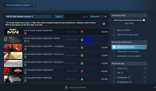

After which, locate the 'store' page (Top Left) and search (Top right) for 'call of duty: modern warfare 2 (2009)'
Locate your library and download the game :)

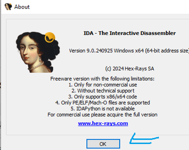

Step 3: Install IDA
Use the link and download / install the free version of IDA

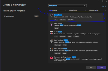

Open visual Studio Community
Select create a new project -> empty project c++

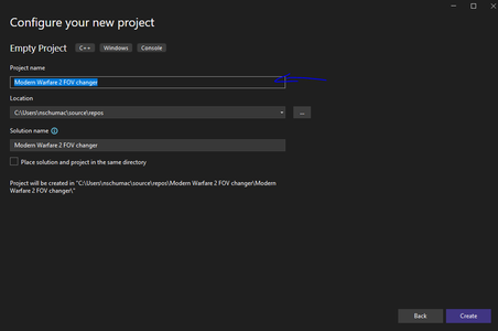

Name it and maybe select a folder where it should save the project files

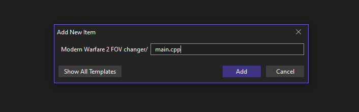

Once it's finished opening the new project right click on the solution explorer and add a new 'item'
Add and Open the new .cpp located int he solution explorer

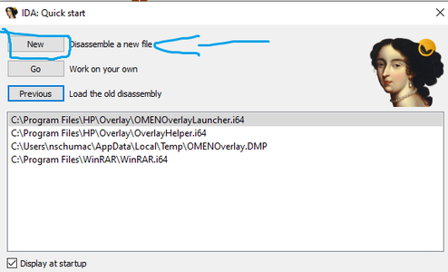

Open IDA which should be installed otherwise see step 3.
Launch IDA

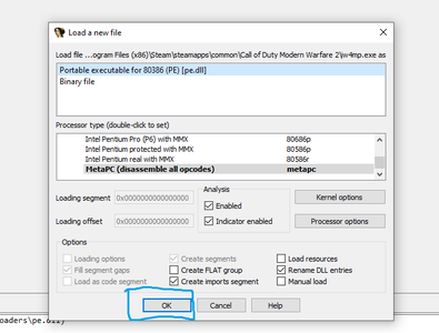

Select new which will open the dissassembly window
It might request you to add the license, don't worry download it from your IDA account and select it.
Once open it'll request a file to dissasemble select iw4mp.exe foudn in the common directory of the steamapps
press ok, IDA automatically knows what file type it is from the signature.

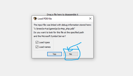

Press no, as there are no PDB files to load (these are created normally for debugging purposes, but ofc won't be shipped with the game)
wait for it finish indexing / loading hte exe :)

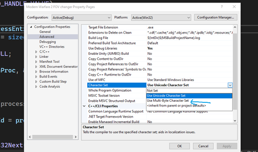

Before starting to write make sure to set your program to use the multibyte character set instead of the unicode otherwise certain functions might function differently (you can always play around and see)
