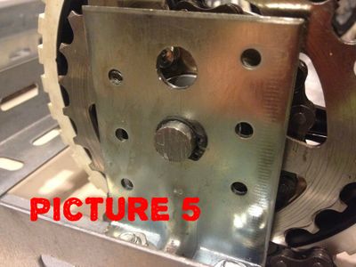

Step 6: Placing Our Driver Motors and Chain Connection
Check out the video at this step to see how it is going to be like when our system starts to work.
Before you start implementing this step. Read all the way through the end of this step. You may want to change somethings.
First of all take one of L shaped brackets and place it near to your tire. You should do this placement according to your motor dimensions and your chain length (read whole of this step before you start) . And open holes on your bracket to mount motor on it and also to mount your bracket on to our chassis. Don't forget to open same holes on top of your chassis as well. (dimensions of these holes depends on you - I suggest M4) See the pictures 1-2-3. I also used wooden block to elevate my bracket. If you use long enough L shaped bracket, you will not need it. See it in the picture 4 (use the same brackets from the previous step)

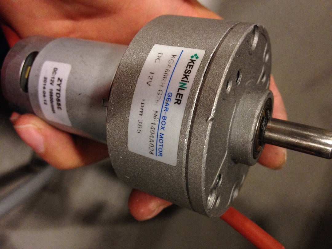

It is time to mount our motors.
Let us meet with our motors. See them on pictures 5,6 they are 385 rpm high torque motors. Unfortunately provider didn't gave any info about their torque value but you can check it by observing output of 385 rpm from 10800 rpm core proton motor. I suggest you to use more powerful ones.
Take one of the unpolarized capacitors with 100uF and solder it in between + and - edges of the motor. See the pictures 7-8 also take some sockets for easy plug in and out, solder them into the edge of at least 25 cm fire resistant cables. And other edges of the cable must be soldered into our motor. Remember the colors for + and - See the pictures 7-8
if you don't solder capacitor in between them, your motor driver will stop working and you won't be able to move the robot.
Now mount the motor into bracket. See the pictures 9-10. The fastener dimensions will change according to your motors requirements. I used 4 philips head M4 25 mm long fasteners per motors.
To connect our gears into our motors, we designed a part. You can see it in the picture 11 and we used fifth gear of any bicycle. You can change this gear as you want. See it in the picture 12. You can use different gear as well but don't forget to change the design that we provide. And before you buy a bike gear check the correct dimension according to our drawing.
See our drawing in the attachment (its name is motor but it is not a motor :D just a name) You can open with software called inventor
Connect our designed part and bike gear with fasteners. we used M3 with the length of 4 cm to fasten them with corresponding bolts. You may want to change the length, it might be a bit long. Check it before you proceed. You can see assembled gear at pictures 13-14
At picture 15 you will see that we added two washers before we connect our gear assembly into motor mil. These washers are M8. You can reduce their size according to your motor mil.
It is time to connect our chain. To do that you need to correctly measure the length. Because you want your chain to be as tight as possible otherwise you may lose it in a crash in the battlefield.
Due to this fact prepare your chain length at the very beginning of this step while your are arranging the distance of your bracket from the tire.
See the pictures 16-17-18-19-20-21 for how its going to be look like.
Don't forget to stabilize gear attached parts into motor mil via setscrew or retaining rings

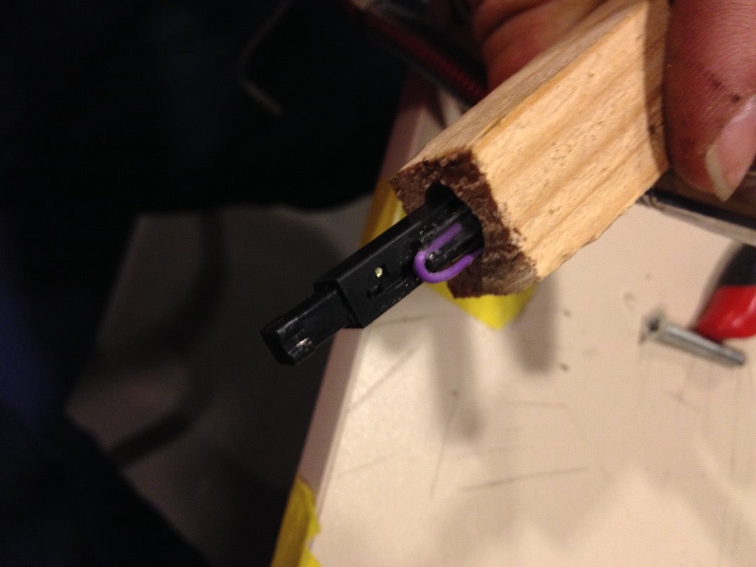

Take one more kitchen lighter with a metal and adjustable neck and dissemble it. The part we are looking for are shown in the pictures 21-22-23.
Take the spark producer and put it inside the wood stabilizer. See the pictures 24-25-26-27
Two cables from the spark producers will come out. They shouldn't touch each other. When the spark producer triggered the spark will jump from one cable to other. I assume that you know a lighter works. So that take these cables and by looking pictures 28-29-30 arrange them.

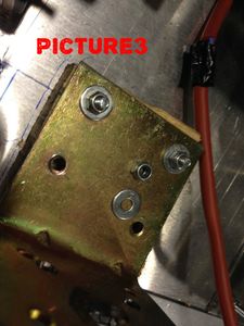

Put Arduino inside our box and stabilize it. Make connections (pic3) and mark the cables (which one is which ?)
Then allow cables of bluetooth module to go out of the box from the roof. And the cable goes out from the roof must be fire resistant with 4 inner cores. Also put upload switch on the roof as well. See the picture 4-5
Then all the cables that are going to connect Lipo, servos and motors should go out from the side of the box. See the pic 6-7-8 and plug arduino programming cable as well.
