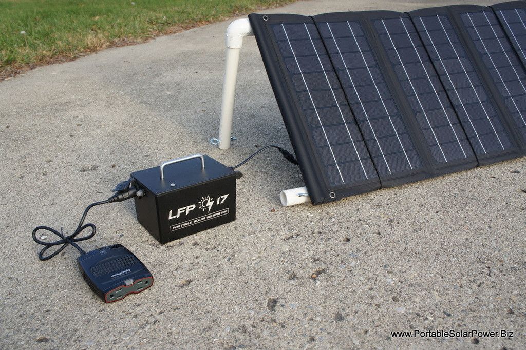

Make sure you test it out and use clean water. but it works perfectly and since mine need to be plugged in, I just use my solar portable generator that I built to power it.

I've actually built a solar generator. I will be posting an instructable on that prolly a little later today.
