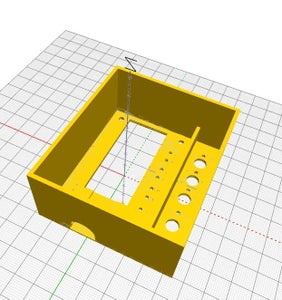

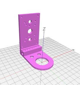

Step 3: CAD Design
The majority of the 3D printed parts were designed using TinkerCad.
These parts are the scale_load, scale_clamp and the scale_nut.
One of its attractions was the screw thread generator to create the clamp and the nut.
However, the right angle bracket and the enclosure were created using BlocksCAD.

4: Bracket. Size: 80(L) x 50(W) x 94(H) mm, Weight: 48g
5: Enclosure: Size: 72(W) x 83.5(L) x 35(H) mm, Weight: 38g

There is also an opening on the right hand side coincident with the USB socket on the microcontroller.
This alows access as an alternative power source and software editing without having to open the main cover.
If not already done so, fit the RP2040.
Fit the protective film into the main cover, if necessary secure in place with a flexible adhesive.
Scale bracket
To the scale bracket secure 4 x 15 + 5mm plastic threaded standoffs (one in each corner), and a washer with nylon screws. Insert the screw through the corner hole in the rectangular section of the bracket followed by a washer and the standoff and repeat in the other corners.
Thread the leads from the Load cell with the attached 4pin SIL socket and pass it through the centre hole in the Scale bracket.
Ensure the load cell is orientated correcly with the arrow on the end of the load cell pointing downwards.
Secure the Scale arm in place with the large nut.
Pass the leads from the load cell through the centre hole in the Scale bracket and connect to the 4 SIL pins of the HX711 board.
Seat the main PCB on the threaded ends of the standoffs, secure the PCB in place with 4 x 15mm plastic threaded standoffs.
Fit the main cover with the 4 corner holes aligned with the standoff holes.
Secure the main cover at the front via the corners with 4 x M3 x 5mm plastic screws.

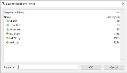

Step 12: Software
The software is written in MicroPython v1.15 using Thonny 3.3.13
The firmware library used was rp2-pico-20210418-v1.15.uf2 this and/or an updated version can be downloaded from the Waveshare site under Software Setup which also includes installion details if required.
Once the firmwave is installed and a connection is established to enable programming.
Rename library hx711f.py (load cell), to hx711.py and copy to the RP2040
Copy library LCD096.py (display), to the RP2040
Copy the three text files ftypes.txt, spool.txt and fdia.txt to the RP2040.

I created the files with Notepad loaded these into Thonny and saved them to the RP2040.
Run the calibration process (Step 13), and edit the calibration factor in Filament_Scale6.py before renaming and copying.
Rename Filament_Scale6.py to main.py and copy to the RP2040.
