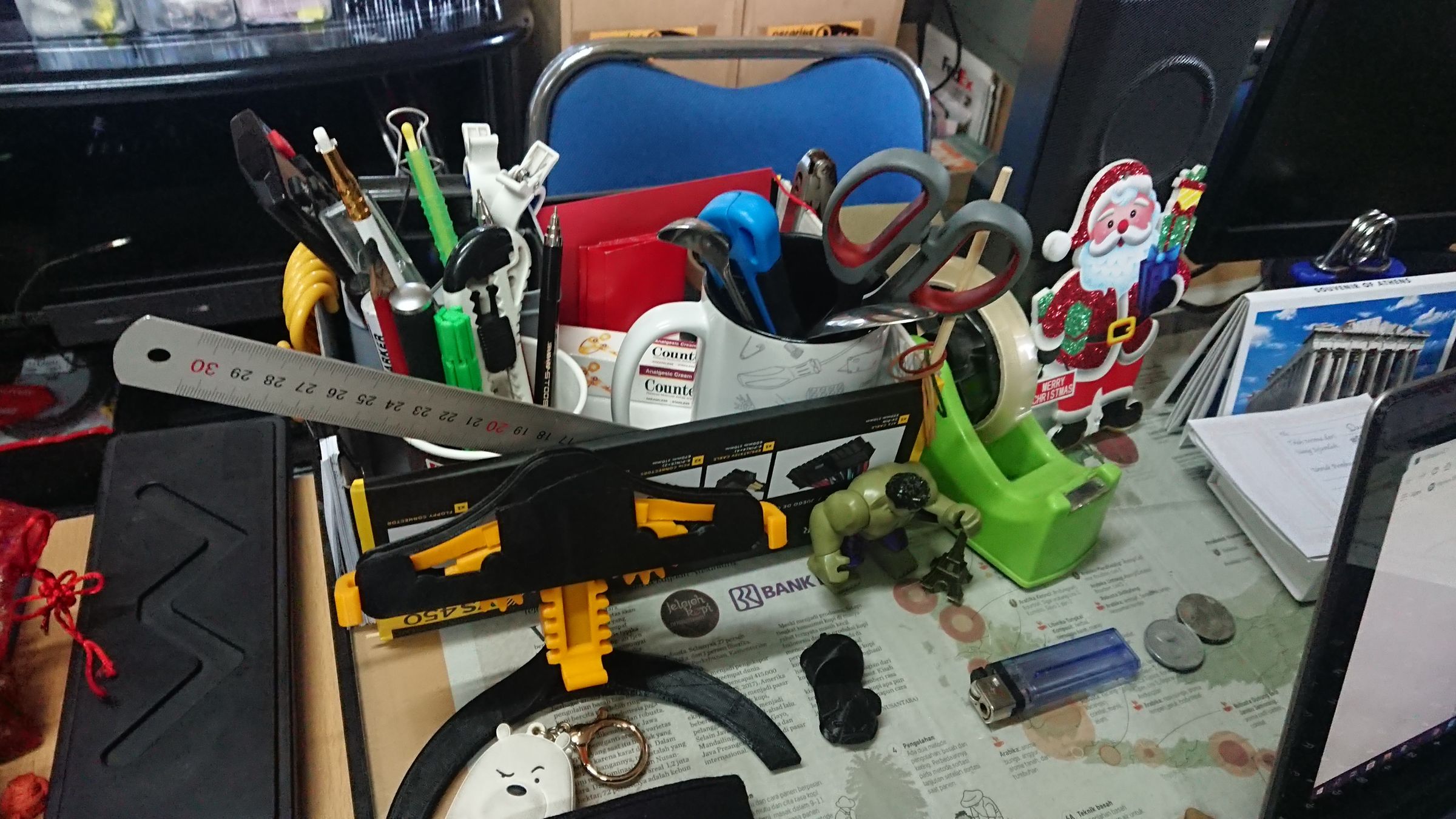

Before this, my desk was messy ... er... well... not that messy but crowded, unorganized, less organized or I don't know which term was best describing it. Here it is :
At least they were organized in a box and cups. Those are frequently used items I keep within my reach. Then I just finished my first roll of filament and I was kind of boring with rectangle and likely switching to round empty filament spool.
Ideas on the net are all about turning empty filament spools into containers or drawers and I need a fresher idea. I was thinking to keep all the frequently used items on that spool (or as many as possible). Then I started designing and printing these Add-ons the whole day. Yes, in a day. Emmm... 9 hours actually, the whole day I spent in the office. Well, don't try this at work or you will be fired. Me, I am an assistant to my father and I still did my work in between printing time ^_^

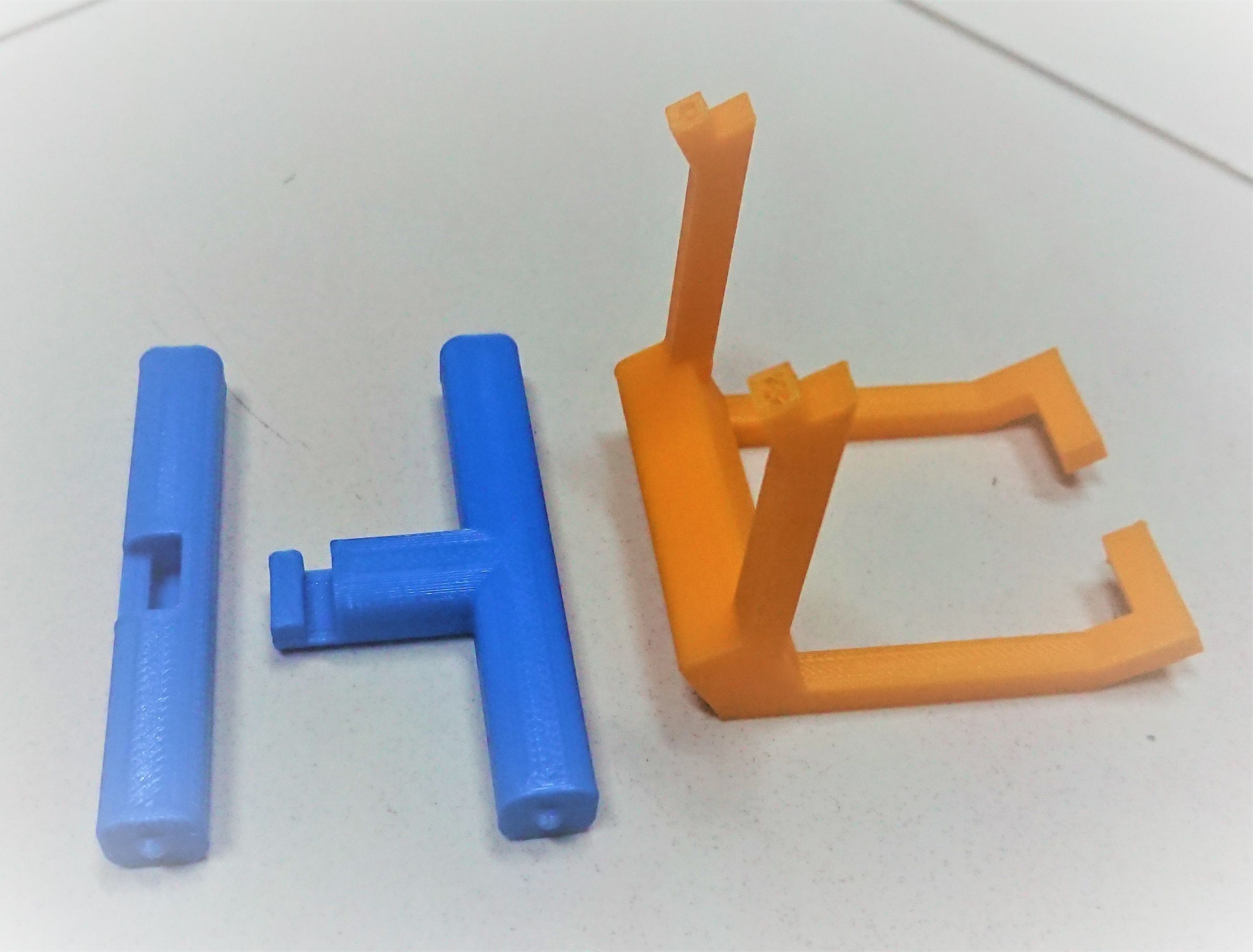

This is the most complex in the system, but then I can get rid of the bulky tape dispenser from my desk. I tried to make "the blade" but I failed. It was promising by the shape, but it is not sharp enough to cut the adhesive tape. Resolution of my printer is not fine enough? Maybe. But I have a solution to that.
You can use the blade of your tape dispenser. Or... you can use a worn-out saw blade just like me. Find some good teeth on it, mostly near the end of the blade. File teeth-side thinner for better cutting experience. Carefully break the blade about 25 mm long by using tongs (use goggles for safety precaution). Slide in the slot as seen on the photos above. It was desinged perfectly for 12 mm wide saw-blade, so you might need some adjustment if you use other than that kind of blade to fit in the slot.
The vertical bar (SpoolTapeSupport.stl and SpoolTapeSupportHook.stl) also function as support, prevent bending when you put something heavy on top of the spool. My CCTREE (brand) filament spool has two oval holes separated by 20 mm at both sides, top and bottom -- designed to hold filament's end -- and my support bars were designed with little domes on top and bottom and they stand right at those holes. If only your spool doesn't have that kind of holes, you can drill 3 mm holes on it to hold the support bars.
Why different support bars? So that you can change your empty adhesive tape with a new one. See photo #2. You won't find a better experience with this tape dispenser system if you use it frequently, but some space on your desk is freed.
Rotate those items carefully and you do not need any support printing them. Okay, I give hints then.
