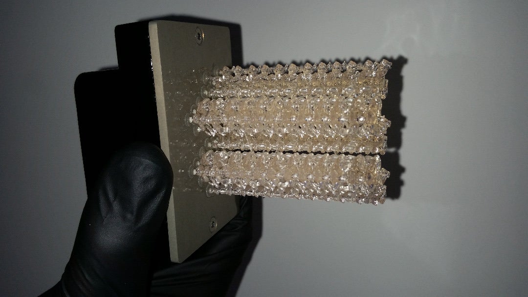

After you've got your settings set, get ready to wait a really long time. Once you click Generate Supports Meshmixer is going to think really really really hard. So you should probably have something else to do. This will take some trial and error and experimenting all the way through printing. The picture with the colorful Spark Logos was my first attempt at support generation I had the Solid Min Tolerance too close, the Density way too high, and much too big tip diameters.

My first print with Spark Logos came out impossible to clean. There were just too many supports and many of them were attached to the parts at more than just the tip. My second attempt all but one printed. It was at the top and I was using 0.015 tip diameter supports so it likely just failed from the torque, if I increase the density a bit I could probably get it to come out. The first time I printed the gorillas they strangely came out half as thick as they were suppose to, but that was ok because I again had too many supports to remove and the tip diameter was leaving really big marks (0.04 tips). When I printed it with fewer supports and smaller tips I had 7 out of 12 layers of gorillas print. Tthese were at 100 micron layers if I went down to 25 they'd probably do better, but then I'd have to have patience.
