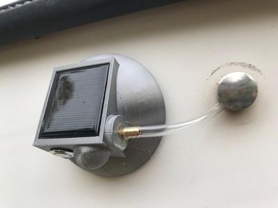

I designed a new device that provides highly accurate control of any tank filling (land or sea). You set a plastic tube at the desired level and fill until an alert goes off. Battery operated, cheap--$30, portable and being an Intructable easily built. No Responsibility Disclaimer: I know nothing about electricity and volatile fuel systems so don't use this with anything flammable.

I built two different designs. The designs are 3D printed and their associated files follow. The solar recharged model has eagle files for mounting all components to one board complete with buzzer. It includes the charger module, Itsy Bitsy and the sensor with associated capacitors and resistors all mounted to the board. The other model is hand built with a separate housing for the sensor attached to #2. The resistors and capacitors that make the sensor work are wired onto this board as is described in: https://www.instructables.com/WetRuler-Measuring-...

Step 2: 3D Print It
These are the STL files for the two versions. The first version is solar charged and comes with an inclusive PCB with all the components on it. The switch, buzzer, battery as well as solar cell are connected to the pin-outs on the side. The sensor is connected by a 3D printed nozzle to a brass hose connector placed in the 3D printed housing. There are holes for 4mm screw inserts that are in the design. Both files for the base and top are included. No supports are necessary and it is printed in PETG for outdoor use. The other version is is designed in two parts which are joined by 3mm screw inserts. Both upper and lower parts are printed with supports. The third design files are for the sensor body and exit tube associated with the second design. It encloses the sensor on the SMD card that is then sealed in epoxy.

Solar Unit: After populating the PCB board and connecting battery, switch and solar panel super glue the 3D printed tube attachment horn to the top of the sensor unit. Carefully apply gel superglue to the vertical rim of the stainless portion of the sensor and carefully push the tube connector down until it hits the stop. To assure a hard connection drizzle two part clear epoxy over the horn and the unit and allow it to connect to the board. Drill a hole in the Solar panel inset and connect the small solar panel. Use E6000 to glue it into position. All tubes used in this Instructable are the variety bought at the aquarium supply store for air supply use. Mount a brass connector for this type of tubing with swedges on both side in the hole in the side of the 3D housing. This will connect the board with a small length of tubing to the inside barb and allow you to connect the outside barb to any length you want. Mount the beeper deep into its dome housing with hot glue. Mount the switch in its housing. Mount 4mm heat mounted screw insets in holes provided. Close the case.
