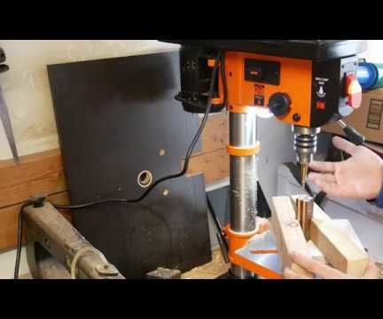

Put a bit of glue in the hole.
Step 3: Shove the Dowel in There and Cut It
Put the dowel in there and cut it with the flush cut tool.
Step 4: Cut Square
For the next one, you need to cut the dowel square on since the tip is already at the angle that you need it.
Step 5: Repeat As Needed
That's it! Keep going.
