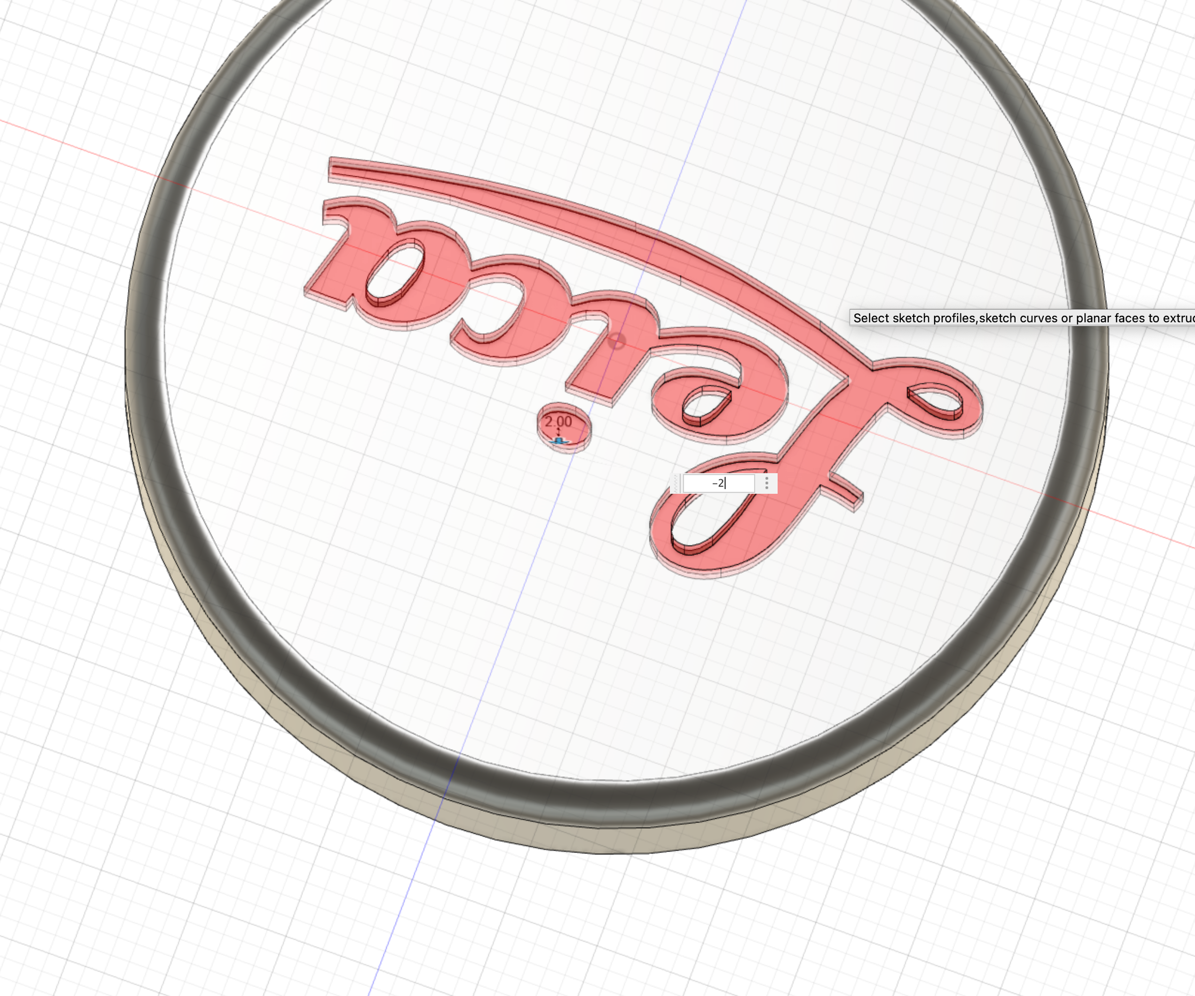

The bottom of the canister has two stage indentation. The inner one can serve as a natural press fit socket. The measured diameter for the inner socket is 9.6mm. I interpolated 6 poles with diameters ranging from 9.5mm to 9.8mm and height of 7mm. For the outer indentation, I interpolated 6 cylinders with diameters ranging from 22.0mm to 23.0mm and height of 1.2mm.
After the press fit test, I chose 9.76mm and 22.84mm as the two diameters.

The final goal is to design a holder to hold multiple canister. Before design multiple version, I design a stool to hold a single film roll with the dimension. It fits pretty well with my Ektar 100 film canister. The max diameter is same with the bottom of the canister, 25.1mm.
Step 3: Multiple Version Holder
By duplicating 6 copies of the singe version stool and create a square block to connect them, I got this shape. It works pretty well with holding 6 films. The distance between the two film canister is perfect.
