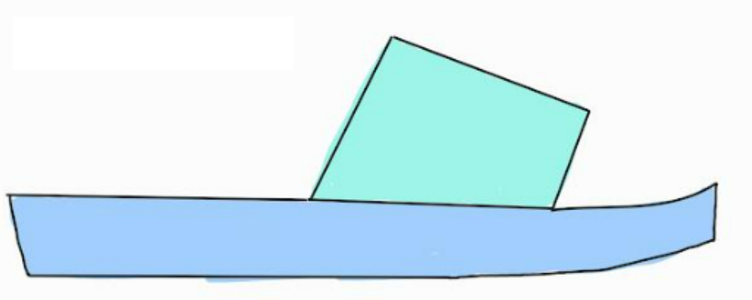

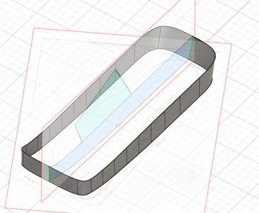

Step 3: Exploratory Sandal Drawing and Challenges
I began by finding an initial sketch of my feet size and roughly tracing it/building a sandal to it in Fusion 360 just with the basic sketch and extrude tools. My main goal with this was to experiment with how a potential sandal would look like before I tried out any tutorials. I discovered that it was very difficult to create a well-mapped, pretty shoe by just sketching and extruding based on a rough sketch.

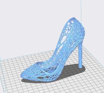

Step 4: Generative Inspiration
I then researched generative slippers, and I came across generative high heels. I fell in love with the abstract, pretty and sturdy nature of the geometry that was created within these shoes, and I was moved to try to generate similar sandals like these.

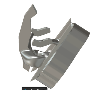

Step 5: Generative Exploration and Challenges
I explored generative constructions for sandals, and I tried a couple of different rough designs out, but I was not able to generate a sandal design that was fully connected and wearable. I decided that the first step would likely be actually mapping my foot out and creating a non-generative sandal that was wearable/comfortable/fit properly, and then based on that, I could add generative features to it so I don't run into the issue of my sandal not fitting.

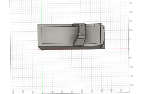

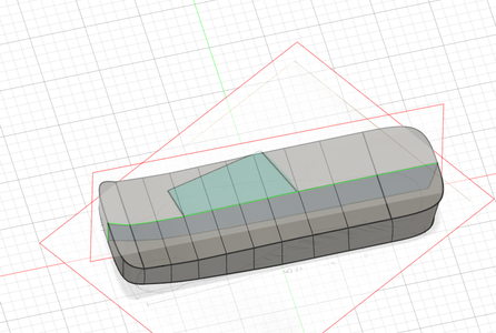

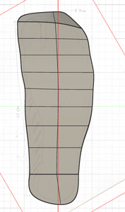

Step 9: Design Sole
I designed the sole of the shoe by creating a form outline of faces based on the shoe canvas and duplicating it across the shoe by the width of my foot plus 0.5 cm for extra space. The goal would be that I would eventually use the edges of the faced to map the shoe to my foot. After duplicating, I bridged the two T-spline bodies together with creases and filled any holes remaining to create a solid sole.

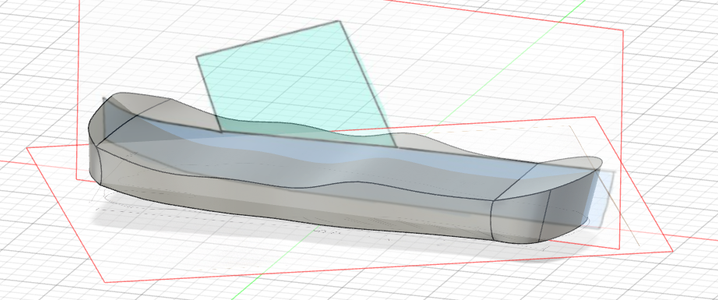

Step 10: Map Sole Form and Depth to Foot
I mapped the sole onto my foot by editing the form of each edge until the flat sole aligned with my foot (plus some extra space as a buffer). Afterward, I analyzed my feet, and modified the depth of the sole (by editing the faces) based on the high and low points of my own feet. This overall process was relatively small, yet crucial as it would determine overall shape of my shoe.

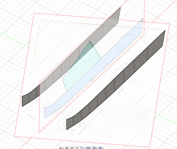

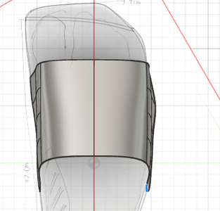

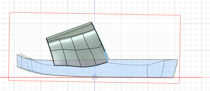

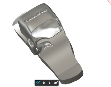

Step 11: Design Strap and Challenges
I chose to add the strap directly on the design in order to prevent assembly issues later on. I created a form with faces based on the show canvas, duplicated it across the width of my foot + 0.5 cm, and bridged them (with creases off this time). At this point, I had four faces, and I spent a significant amount of time trying to figure out how to map the strap directly onto the sandal (I went back and checked the tutorial, and it did not cover this). Eventually, I realized I could add more points to split edges or add more faces themselves, and because of the complex shape of my foot, I ended up having a lot of edges to map.
The overall mapping process of the design strap took between 1-2 hours as it was difficult to get it exactly right from the top, bottom, left, and right views. I had actually finished it and cut the grooves (Step 12) before realizing that the edges were floating, so I went back in the timeline and spent 30-45 minutes getting the edges exactly right.

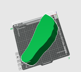

Step 13: First 3D Print
I combined the strap and the sole into one body and exported it to the Bambu slicer. I printed it with gyroid infill at 5% density, and I chose to add tree supports in order to limit the amount of support cutting I would have to do at the end of the print. TPU supports, from my research, appear difficult to remove, so I was hoping that the branches would make it easier/less targets to remove. Also, printing with tree supports would result in a 5 hr faster print, so I went with that. Furthermore, after consulting with Jennifer, we made the retraction length 2 mm and the retraction speed 20 mm/s for a better/cleaner print and to hopefully avoid some stringiness. The print time was around 15 hours.

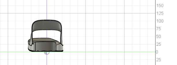

Step 15: Modification Implementation
Fixing changes (a) and (c) were relatively quick since I just needed to adjust the Bambu Slicer settings. I realized the reason I had to make change (b) — as I had previously thought my mapping was perfect before I printed the shoe — was because I had missed mapping a line from the Back view. Making the change was relatively easy because I was so familiar with the mapping from earlier. I fixed (e) and (f) by traversing back in the timeline and making the edits in the appropriate form creation. Implementing change (d) — the name — took the longest time because I wanted the name to fit perfectly on my 2 mm thick strap without extruding past it, but also touch the bottom of the strap so that it would be as sturdy as possible. I ended up typing my last name, extruding it, and fitting it over the strap. I then used a Boolean operation to remove the extruded name from anywhere else besides the inside of the strap and the top. When I took my updated design back to the Bambu Slicer, I found that the Slicer had added support generation across the name to ensure its stability. My new print time was now around 17 and a half hours (2 and a half hours increase)

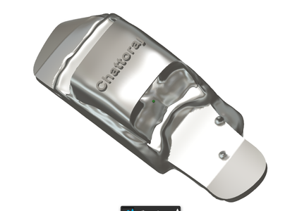

Step 16: Mirroring
Since my feet have similar shapes, I decided to mirror the right shoe to get the left shoe body to print. I mirrored it by following Autodesk's instructions for mirroring a body, but I realized that while the shoe base and strap mirrored fine, the name was mirrored backwards. After playing repeatedly with the software, I discovered through trial and error that in order to mirror the whole design completely, I would need to traverse back in the timeline and mirror the base and strap separately. Then I would need to duplicate (not mirror) the name and recombine all the bodies into one. Following those steps, I was able to successfully mirror the shoe.

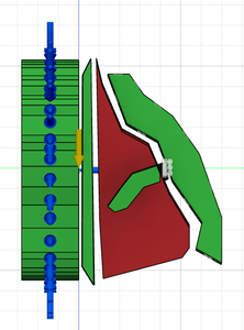

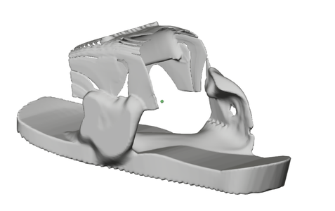

Step 17: Generative Excursus
Before I gave my shoes for printing, I wanted to make one last attempt at generatively creating my shoes by playing with the final shoe design that I had created. I separated the name, the strap, and the base, and I assigned them to be "preserve geometry." I then created an obstacle geometry between them, and I gave the design for outcome generation. This was my most successful generative design so far, yet it was also not printable as the mapping/dimensions were now off. I think that in the future, if I was to explore further into generative design for footwear, I would focus on small generative aspects (the outline/form) and create perfectly mapped obstacle geometry and starter parts, but even so, it is likely the shoe would not be a completely well-mapped piece of footwear.
