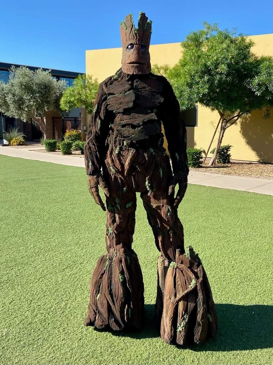

same exact thing as the bottom. Then I created templates for all the armor plates then used 10mm crafting foam
Step 11: Base Coat
I found this Acrylic Spray Paint at Hobby Lobby called Ironcad "Black Matte" and used 4 cans of that for my base coat.
Step 12: Hand Painted All the Texture
I hand painted all the browns, yellows, creams, and greens into the suit. It took awhile but it turned out amazing. I also picked up some reindeer moss at the dollar store and hot glued that on.
