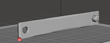

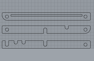

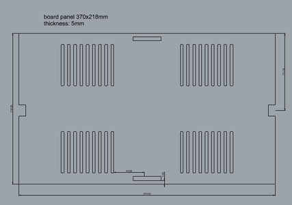

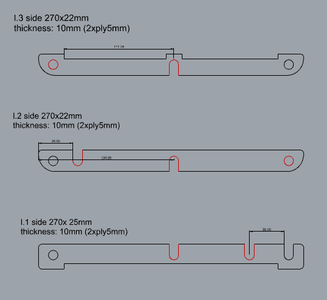

[pic 1] - I reshaped the wooden sides so that the layer 1 side would have space at the bottom for a 5mm plywood board [pic 3] which would add additional support to the stand by connecting the sides. Layer 3 side was also remade so that the board on which the laptop would be placed on [pic 4] sticks to its surface. This was made so that if you want to use any of your side ports you wouldn't be blocked by the wooden side like on the previous model [pic 2].

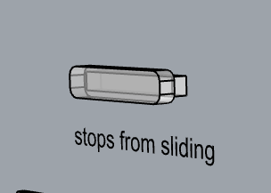

I added two holes on the top board [pic 4] so that a small piece could be placed in [pic 5] to stop the computer from sliding.

This was the part where I decided to alter the plastic sides' shape from cylinders to 3mm thickness rectangles [pic 3]. There are two types of side bars one with: one hole is 8mm diameter for the screws and the other is 10mm diameter for the metal bar; the second type is: one hole 8mm diameter + an additional 10mm diameter cylinder of 9mm length to act as a stopper [pic 4].
