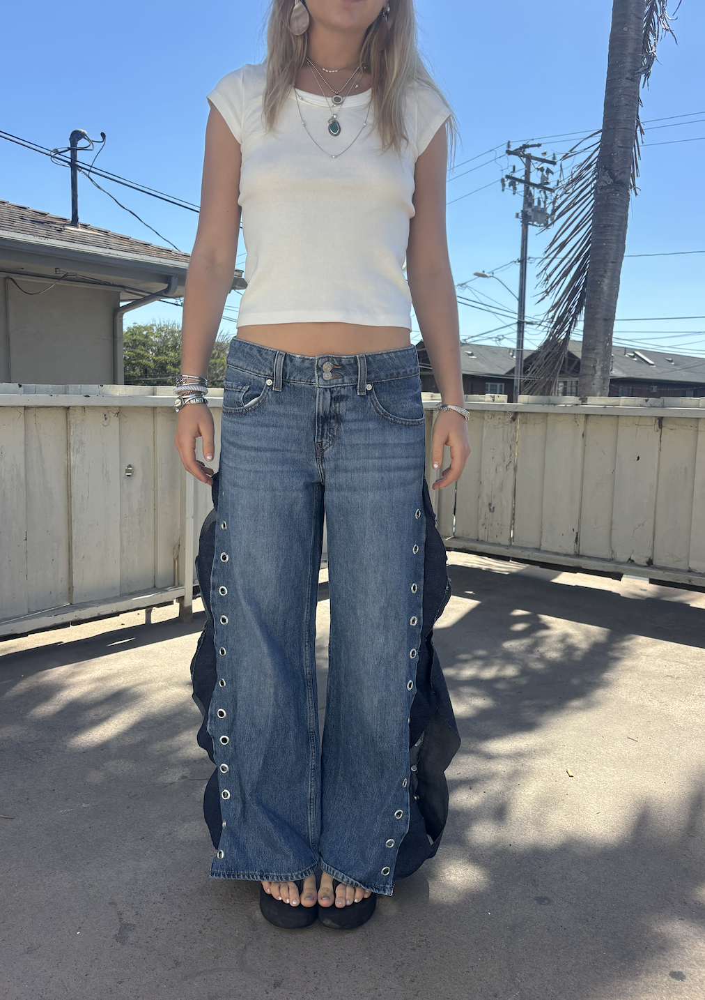

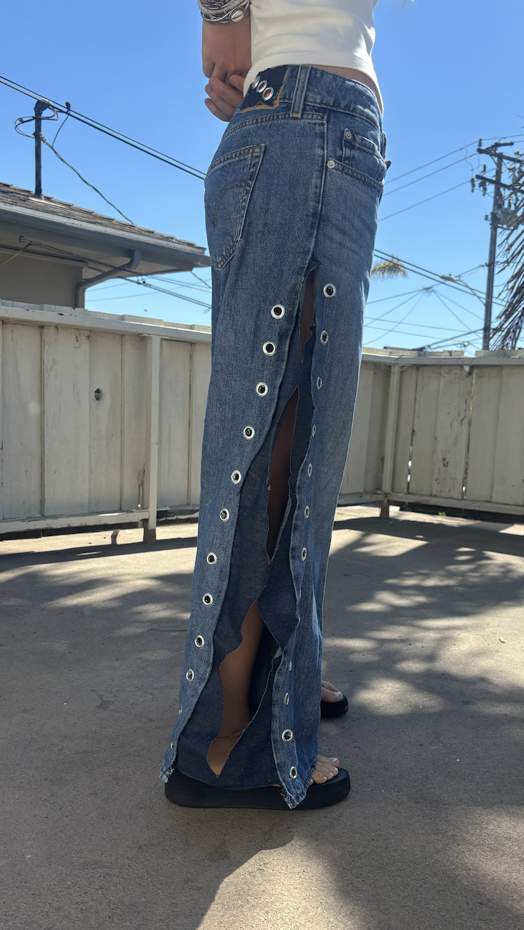

Hi! These are the jeans I upcycled through laser cutting. I created a design in Fusion 360, cut it into denim with the laser cutter, and then attached the pieces onto an old pair of jeans.

Step 1: Sketch and Measure

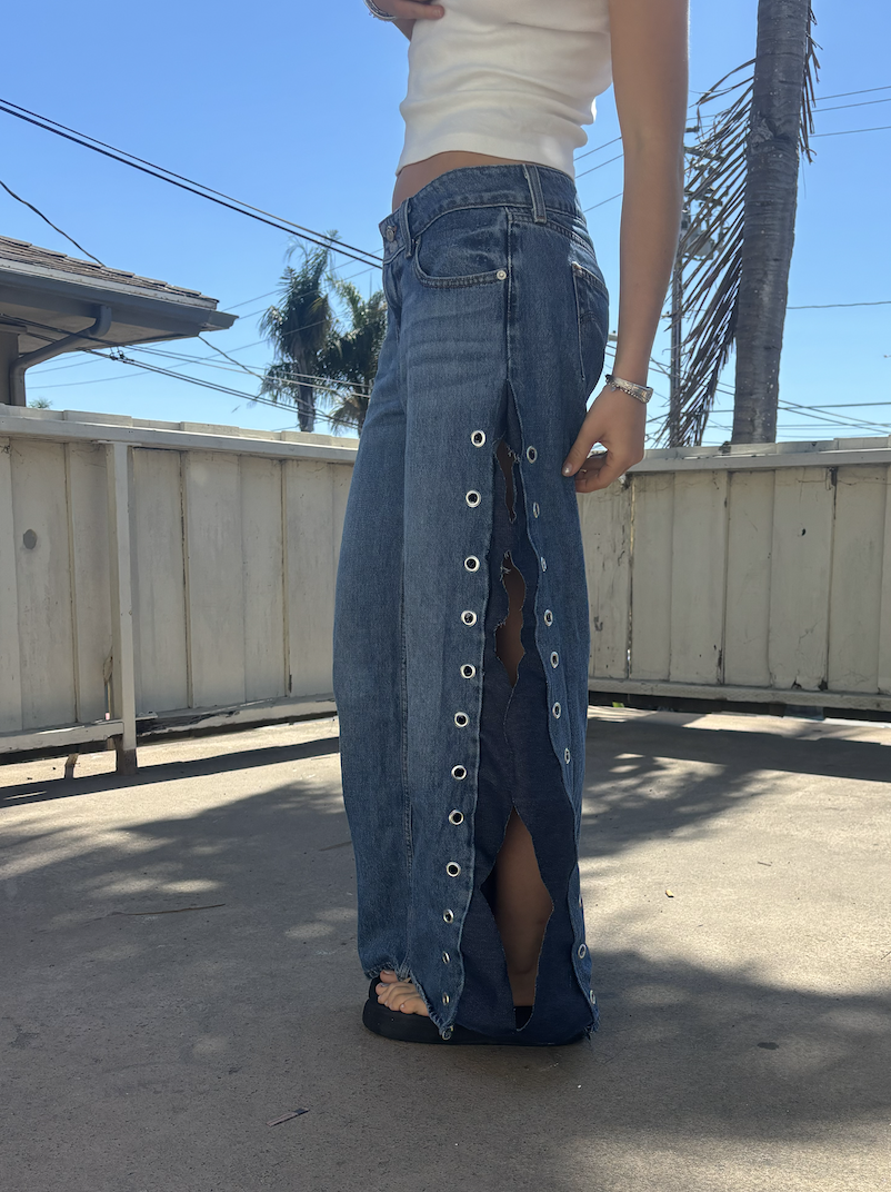

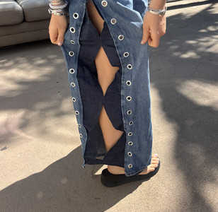

For the first step, I picked out an old pair of jeans I didn’t wear anymore but wanted to give new life to. I measured the jeans and planned out the size of the slit I wanted to create. The slit measured about 33–34 inches tall and 8 inches wide. From there, I designed diamond shapes to fill the slit, sizing them at 12 inches, 10 inches, and 5 inches. These measurements became my constraints in Fusion.
Step 2: Designing in Fusion
I then designed the three shapes in Fusion 360. This took some trial and error because I wasn’t sure how to make all the arcs consistent using constraints. My first attempt involved drawing curves by eye based on the height and width, but the shapes ended up too close together, which made the fabric structurally weak. So I started over.
On the second try, I used intersecting height and width constraints and built out four equal squares as a guide. I aligned all the arcs to intersect the squares evenly, which created much cleaner, stronger shapes. After some tweaking, I was happy with the design and exported it to Adobe Illustrator for laser cutting. Before cutting the full piece, I tested the design by making a smaller diamond pattern and cutting it into fabric to see how it held up.
Step 3: Laser Cutting
The test piece turned out great, with clean edges and much easier than cutting by hand. I thought the fabric would fray a lot because of the raw edges, but the laser actually sealed them, which gave it a clean, finished look.
After testing, I cut the fabric to the right dimensions so it would fit perfectly in the laser cutter. The machine cut everything quickly, cleanly, and without burn marks. The results looked even better than I expected.
Step 4: Sewing
Once the denim panels were cut, I needed to insert them into the jeans. To do this, I seam-ripped the sides of the pants. This part took much longer than I expected because the jeans had multiple lines of stitching, and I had to carefully remove each one. It also created a lot of loose threads that I had to clean up.
After that, I pinned the panels in place and set up a sewing machine in the makerspace with dark blue thread. Sewing the pieces in was a bit rushed since I had to leave for work, and I accidentally sewed one of the diamond shapes closed at the top. Luckily, it wasn’t too noticeable in the final look. Once the panels were secure, I finished the raw edge at the bottom of the pants to prevent fraying.
Step 5: Grommets

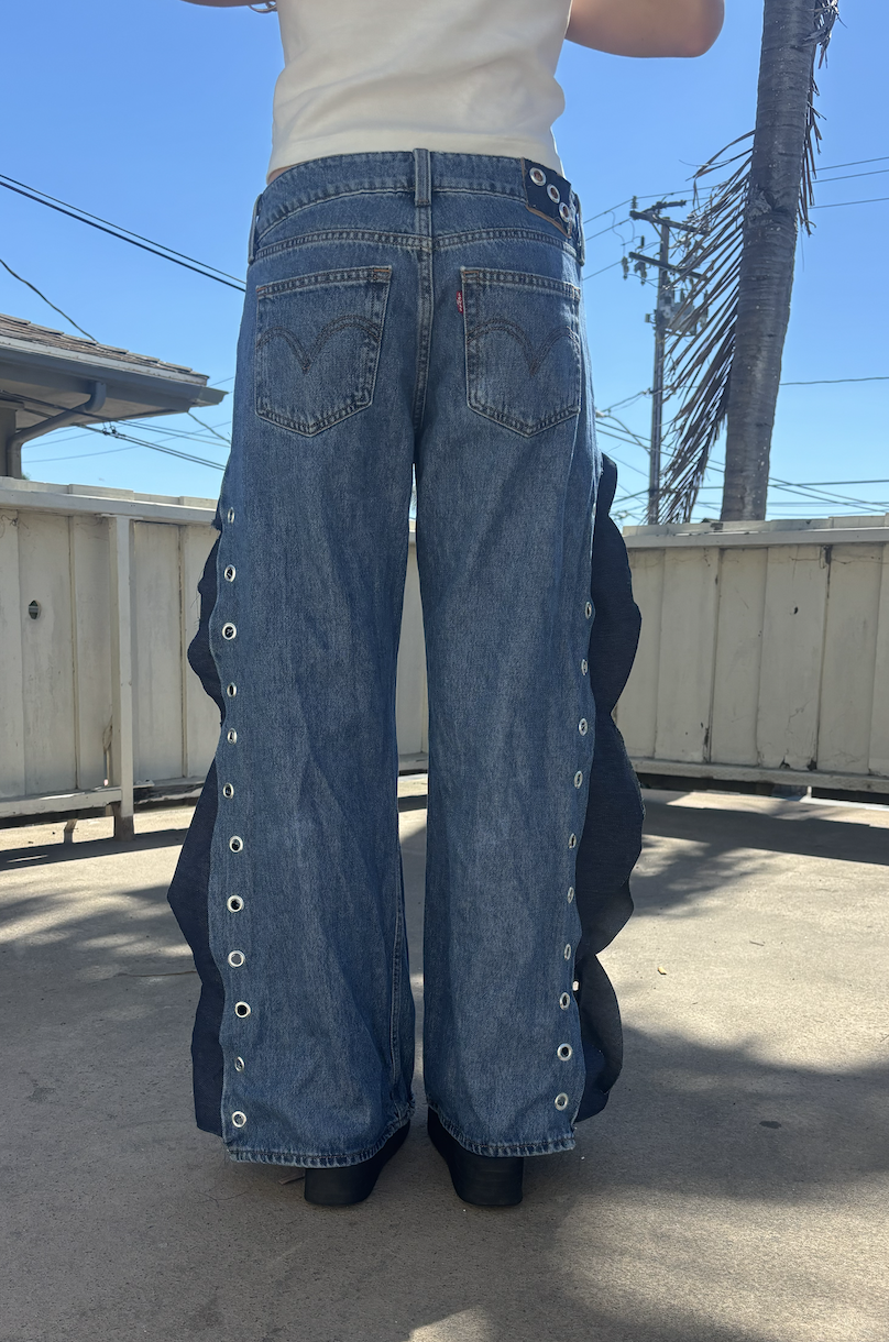

The final step was adding grommets for decoration and detail. I measured and marked placement along the sides of the jeans using a black pen, then individually punched in the grommets along four lines. This process was a little more humbling than I expected since it took a lot of strength (which I don't have) and time to press them in.
I also decided to cover up the old jean tag with a patch I made using three diagonal grommets. Sewing the patch on was tricky because the fabric was thick and the grommets pulled the patch tighter, but I liked the textured look it created, so I kept it.
This was my first time using grommets, and I really enjoyed the process. They added an extra design element to the jeans, and now I want to add them to everything!
