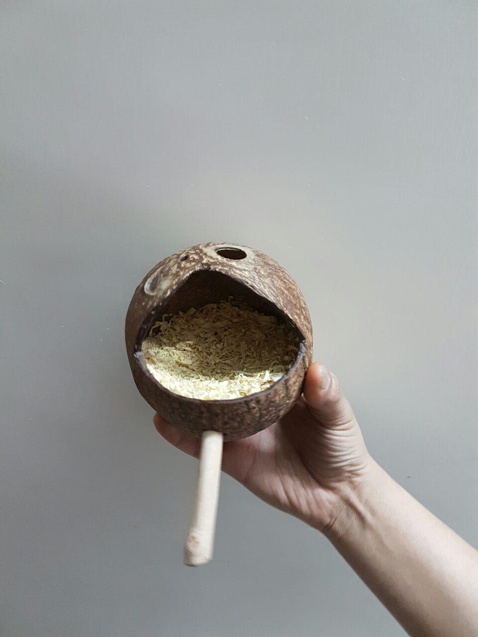

this finch nest (finch house) tested in cage of Zebra finches, Java finches and Gouldian finches.
in the first pic u see two chick of zebra finches (Both female) that goes to the nest for rest n sleep.

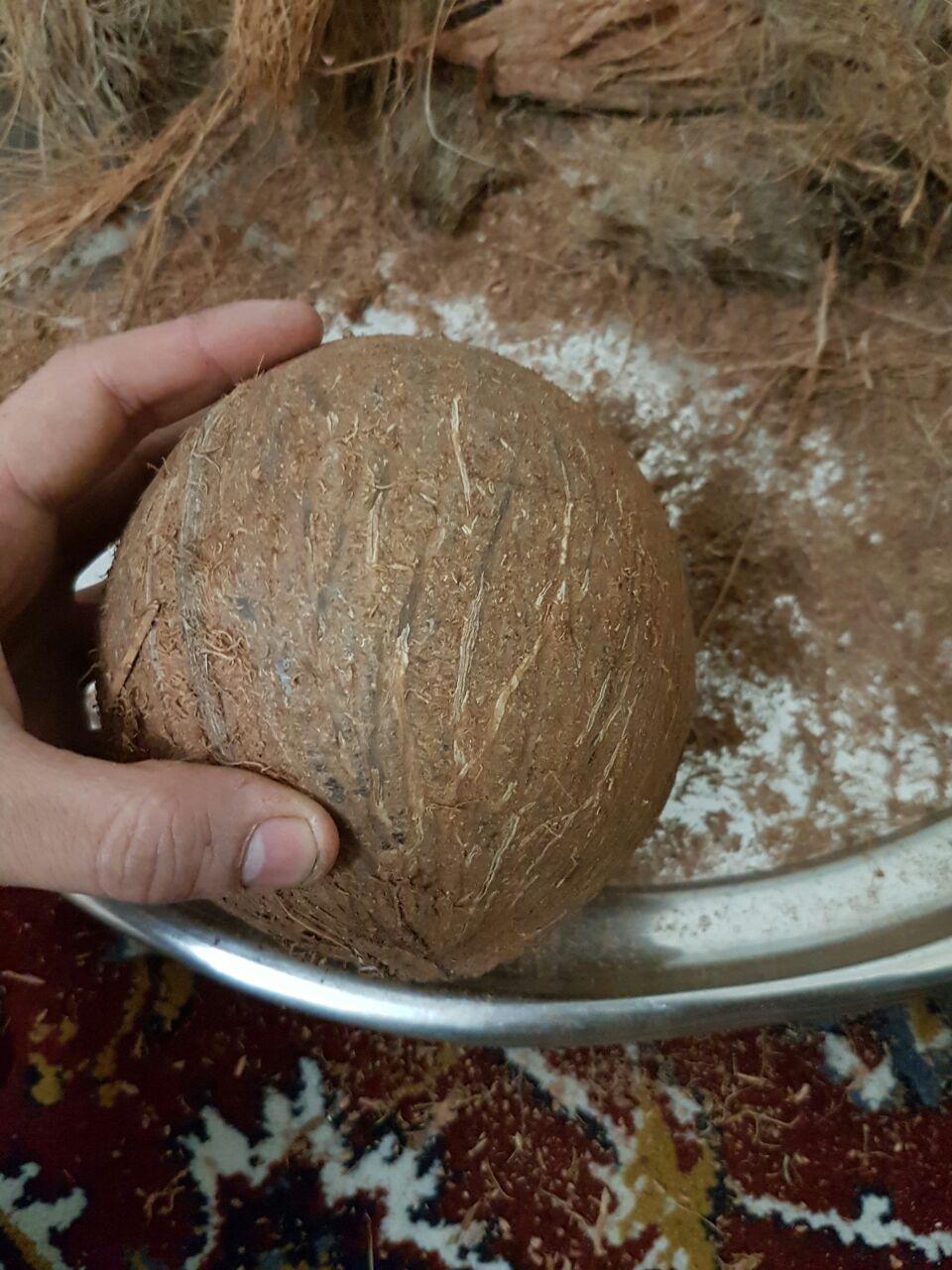

first of all you should make your coconut clean and cut of all hairs. (coconut hairs can use instead of Cottonseed)
coconut has 3 eye and one of them is easy to open. so open it with knife and extract sweet water of coconut.

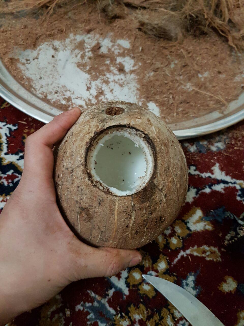

pick a hole saw due to the size of the bird that you make this nest for. 50mm (2 inch) is good for finches.
select the area that you want to make it entrance of bird house. its better to choose it under coconut eyes because the house should be a little deep.
in the center of the area that you choose for entrance drill a 5mm hole before using hole saw.
use the hole saw to make the entrance and due to size of your wood stick make another hole under it.
Step 3: Extracting Meat and Done
you should extract the coconut meat from the entrance hole and i suggest to do it easily to prevent cracking.
after extracting if you have some cracks like mine you can fill them with wood glue.
insert the wood stick to the hole and use wood glue or mdf glue to fix it.
your finch nest is ready. fill it with any material that u think its better for your bird.
i used cottonseed in on of finch houses and also used sawdust for another one.
last three pics are another model of nest that has bigger entrance and it can use for bigger birds.
if you have finches in cage its better to fill the nest with cottonseed and give the finches a little grass or something like that. Finches love to build their own nest.
