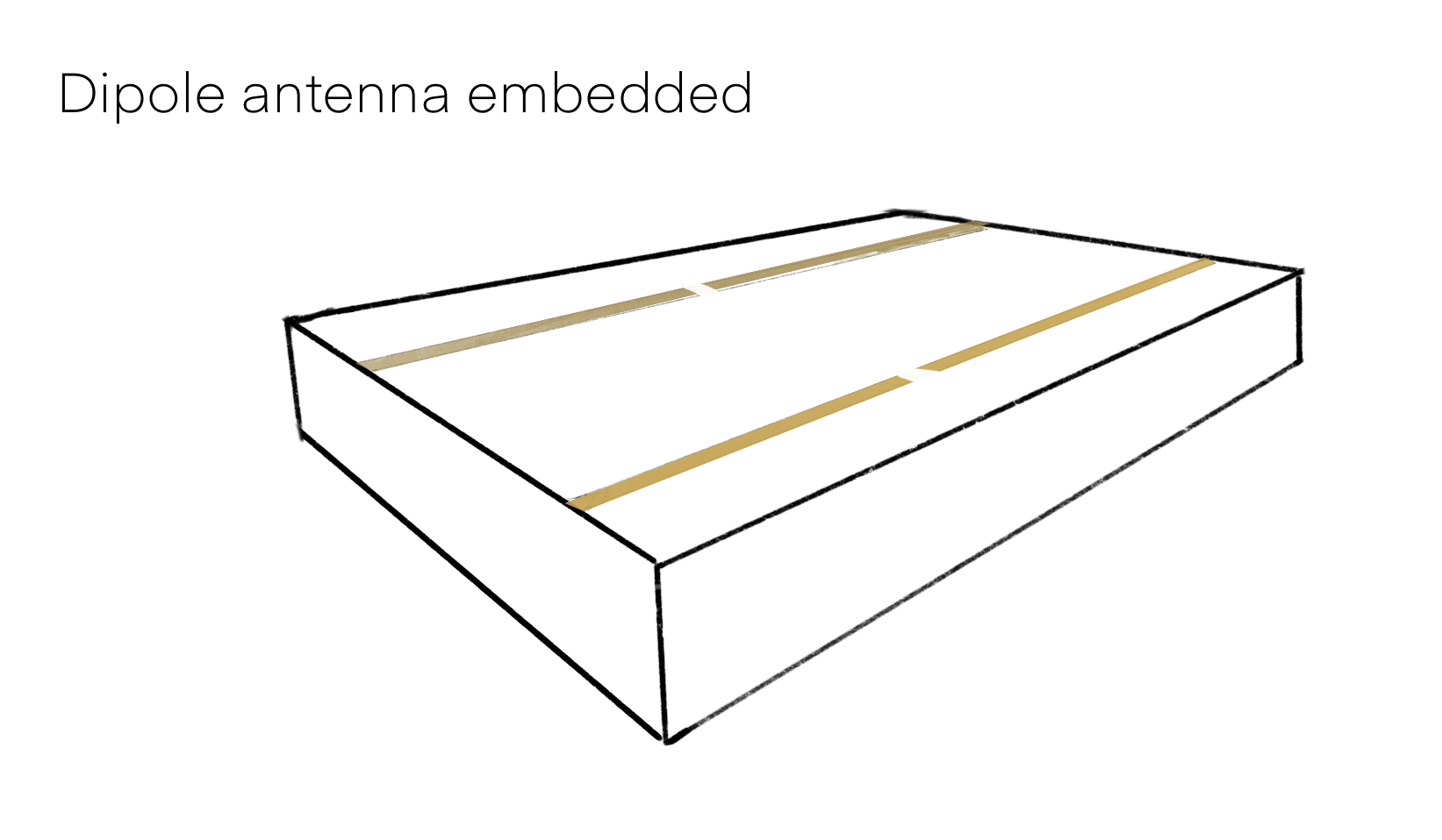

Step 14: Make the Inlay for GPS Antenna
To make the GPS antenna, I chose to build a dipole antenna out of the brass sheet. I found a metal chopper to cut a small 3mm wide rectangular piece of brass "wire".
Using a chisel and a sharp knife works pretty well for making the groove for the inlay, just score the walnut about 1 mm deep and use the chisel to break the material free.
Then once you do that, just lay the wire inside the groove and glue it.
Finally, trim the ends to make the antenna flush with the top case.

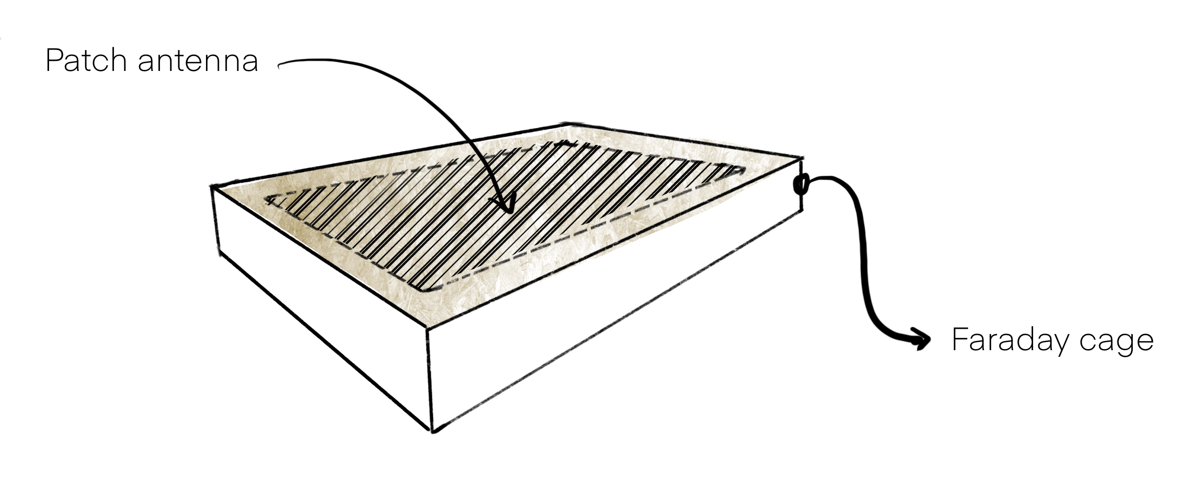

The first design I tried building was a patch antenna. I figured it'd be enough to make it work. But upon plugging it all in I got really poor reception, I could not understand why. After doing a lot of research on RF / Antennas I learned the following lesson. It's probably RF-Enginnering 101 Lecture 0, but, here we are.
Metals do not allow RF (radio frequency) signals to pass.
My first design was like this:
The patch was basically trapped inside a Faraday cage, hence no reception.
After learning that, I thought I could put the patch outside the metal box. But there is a little problem with this strategy: if I wanted to use any commonly available dielectrics for the patch antenna, i'd need the patch to be around 60 mm x 60 mm ~
This would not work for my small form factor design goal.
Doing some research on different types of antennas I found out that there are two other options that could work for my small factor:
- The Dipole Antenna
- InF (Inverted F antenna)
I chose the Dipole antenna, it was simple to build and surprisingly fast fix + accuracy.
The end result looked like this:

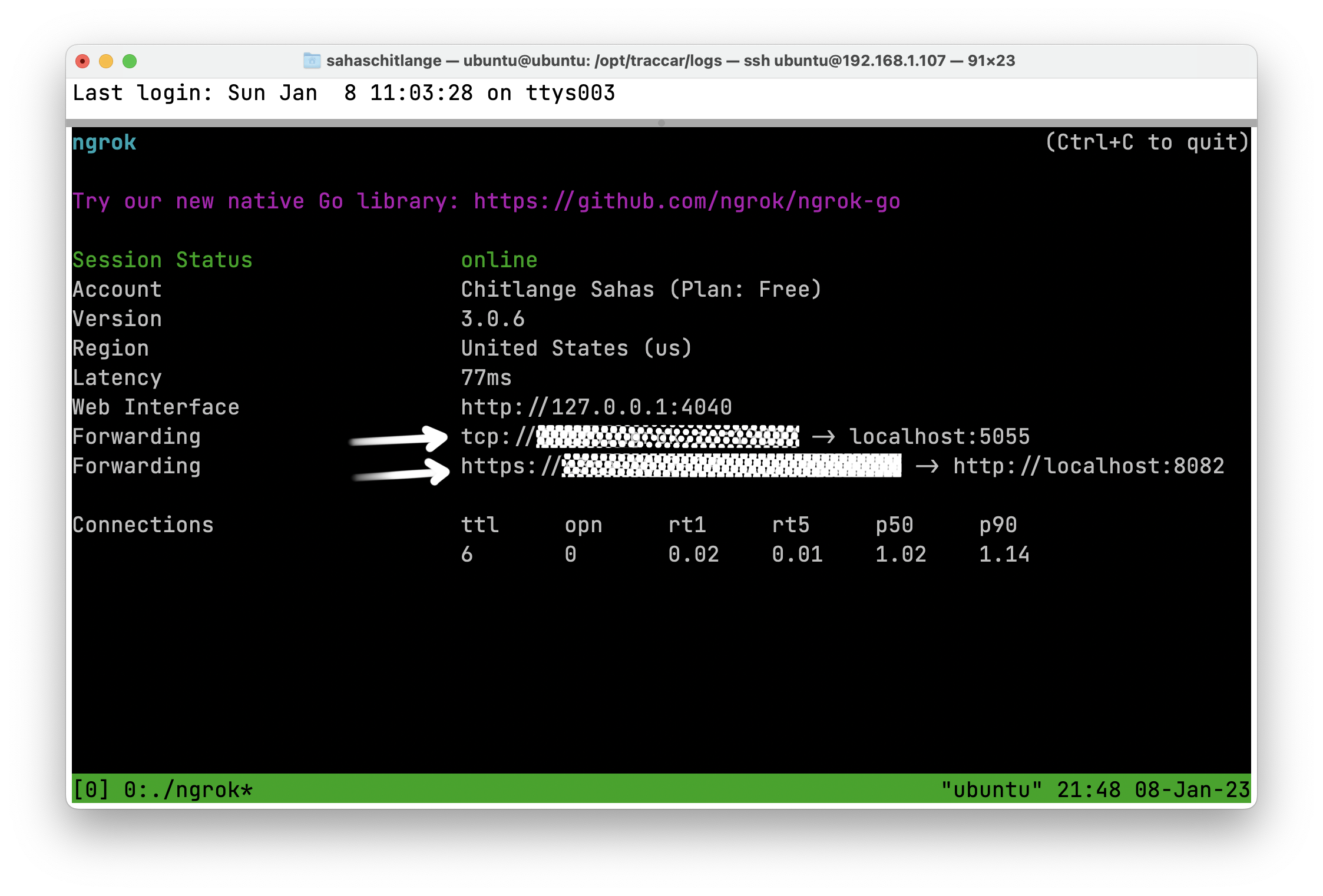

Step 22: Setup Traccar Server Onto Raspberry Pi
I wanted to minimize the recurring costs for this project so I chose to host a server of my own using Raspberry Pi.
The idea is simple:
- Install Ubuntu Server 20.04 on Raspberry Pi. We choose the server image because we don't want the overhead of the GUI consuming resources on the Pi.
- Using your Personal computer, SSH into the Raspberry Pi.
- Install Traccar GPS Server on the Pi.
- Download the Linux ARM binary here: https://www.traccar.org/download/
- Follow the installation instructions here: https://www.traccar.org/linux/

- Install ngrok on the Raspberry Pi, we use this to expose the ports of the Traccar Server over the internet.
- Add the following contents to your ngrok config file (~/.config/ngrok/ngrok.yml). The NGROK_ACCESS_TOKEN is obtained from your ngrok dashboard.
- Launch a tmux session by typing tmux in the cmd line. Install it if you don't have it installed.
- From the session, do ngork start --all. This will start forwarding both the tunnels. (https and tcp as defined in the config file)
- Copy the two URLs that the ngrok session displays, we'll use this in our Python code next. (see images for better clarification). They look like these:
- https://0000-00-0-000-000.ngrok.io/
- 0.tcp.ngrok.io:PORT

image pointing out the URLs:
