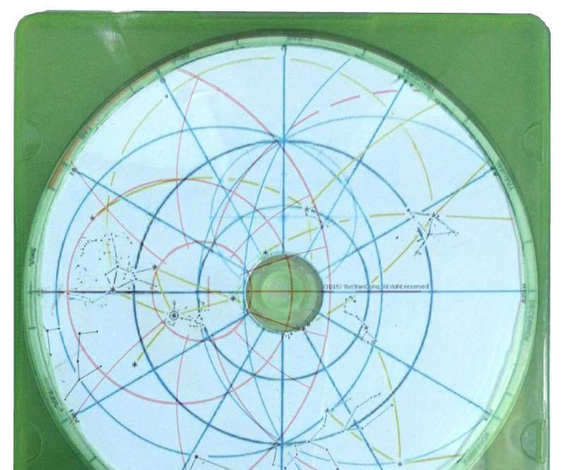

Step 2: Representing a Spherical Circular Shell Having Stars by Flat Sheets of Maps.
Figure of a sphere touching two caps and one cylinder wall. The flat sheets will be used to represent the spherical shell
We want to observe the stars and record their positions on flat sheets of paper.
We don't want to project images of the stars from the center of the Celestial sphere onto the flat sheets touching it. Doing so will require the observer to have his eyes at predetermine distance from the flat sheet maps to keep the shapes of star constellation correct.
Six areas in the directions of the faces of a cube can reasonably represent the area of the Celestial sphere. However we will not use them here but use a tin-can representation having only the top and bottom circular caps and the optional cylinder wall. The caps will have Inversion projection and the cylinder wall will be rolled out with a Mercator projection.

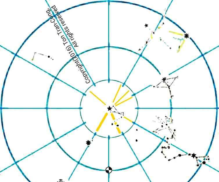

Step 5: Inversion Projection and the Northern Hemi-sphere.
Figure 1,2: Northern Celestial hemisphere (Inversion maps, these maps may be augmented with more stars).
This method let a plane touch the sphere and project all but one points on the sphere onto the plane from the point on the sphere most distant from the plane. The distance of the projection (image) of a point from the center of the projection (the contact point) is proportional to the tangent value of half the arc from the original point to the center of the projection (the contact point). This method preserves the angles of small local features so that users can readily identify the features.
This method makes meridian curves and latitude curves become orthogonal curves. Long exposure photography near to the Upper Celestial pole shows projection of latitude curves onto the film plate. The images are almost the inversion projection. Star paths form family of circles orthogonal to family of meridians.
The concentric circles on the polar map represent the declination circle on the Celestial sphere. They are placed at angles of 30, 60, 90, 120 degrees from the Celestial pole. The non-concentric circle represent the circular path of the Sun on the Celestial sphere. Solar path is called the ecliptic. The yellow circular arcs in my Inversion polar maps represent great circle arcs on the Celestial sphere.
Polar maps are simple to understand. Stars move around Celestial poles 366.25/365.25 turns every 24 hours. Viewed from the Earth, they circle in the anticlockwise direction around Northern Celestial pole and they circle in the clockwise direction around Southern Celestial pole . The Sun also rotates in the same direction but with a slightly lower rate of 1 whole turn everyday. So the stars moves ahead of the Sun by 1/365.25 days. The stars and the Sun will return to their relative position after 365.25 days, that is exactly after one year.

Step 7: The Southern Hemi-sphere
Figures 1,2: Southern Celestial hemisphere (Inversion maps, these maps may be augmented with more stars). The small circle on the top half, on the 24hr RA, of this map is of the same size as a great circle of the Celestial Sphere used in this Inversion projection..
Identifying Southern polar stars
The Southern Celestial pole has no noticeable bright star. Near to it (or not so near, at 30 degrees distance!) there are two bright Pointer stars (Rigel Kent, or alpha Centauri, is the trailing but very bright star and Agena, or beta Centauri, is the leading but less bright star, leading by a 5 degrees distance). Both are on the circle of 60 degrees of declination. Near to the opposite side of this circle there is also another bright star Acherna.
The Pointer stars point (into the leading direction, from a-Cen to b-Cen) at the top of a Southern Cross group of stars (group of 3 not as bright and 1 half-bright stars forming the 4 extreme points of a Christian cross, with the half-bright star at the extremity in the leading direction). The shaft length of this Cross is about 6 degrees, cross bar length 4 degrees.
During mid-nights of March the Southern Cross is upright and high in the Southern sky with two brighter Pointers trailing it on its East. Even people in the Northern tropical zone may see this upright Cross in March on their Southern horizon. However only people living well in the South, at latitude of more than 30 degrees South, can see these stars all year round. The Cross may hide under the horizon, be yearly invisible and unusable to people in tropical zone for a long period around September.
The Southern Celestial pole is of equal distances (of about 30 degrees) to the two Pointer stars and the cross-bar of the Cross. The Southern Celestial pole is thus about 4 and 1/2 extended length of the shaft below the bottom of the Cross.
Before the Pointers go lower than the Celestial pole, they point vertically downwards with the Celestial pole 30 degrees on their left. On the other side of the pole, at the same distance of 30 degrees there is a nearly as bright star Acherna (meaning "the end of the river").
The line of alpha Centauri-Acherna is 63 degrees long and is 105 (180-75) degrees in the clockwise direction from the Pointers' direction. Acherna is the brightest star in the disk of 30 degrees radius centered on it. Acherna can be unambiguously identified and it is still in the sky for another 11hr after a-Centauri goes lower than the Southern Celestial pole.
Achernar (meaning "the end of the river", also named alphaEri, 01h 37mRA, 57° degreesSouth , 0.46 apparent magnitude) has been identified.
The mid-point of aCen-Acherna is close to Southern Celestial pole. Rotation of this line by 10degree counter-clockwise around aCen or clockwise around Acherna places the mid-point on the Southern Celestial pole.
The line of Acherna-Southern Celestial pole is 33 degrees long and is 90 (180-90) degrees in the clockwise direction from the Acherna-Altair direction.

Step 10: ​Notes on Identifying Stars.
Figure 1: Mercator map of brightest stars and great circle arcs to their neighbours. Figure 2: Table of 20 brightest +2 stars in order of appearance.
The term "distant vertex" of a triangle denotes the vertex facing the shortest side of that triangle.
The stars (objects outside the Solar system) to be used as the reference marks on the sky are Polaris (a bright star nearly right on the Celestial North pole), Vega (the second brightest star in the sky, 39 degrees from Polaris, with RA of 18hr36m), Sirius (the brightest star in the sky, 106 degrees from Polaris, 74 degrees from the Southern Celestial pole, RA of 7hr.).
Starting from Polaris and Vega it is unambiguous to identify Deneb and Altair while starting from Polaris, Vega and Sirius it is unambiguous to identify Orion group of stars.
These stars can then be used to identify any other stars in the sky.

Step 11: Using a Polar Map of Stars
Figure 1: Using a star map on the 21st of July, the selected date is on the rim. Figure 2: Using another star map, obtained through the internet, on another date, the 18th of January, which is on the rim, just below the compass. Most of this downloaded map has been intentionally blurred in this illustration for reasons of Copyright.
Select the current date in the year on the rim of the polar map. The Sun should be located at a point on the ecliptic nearest to this date on the rim. The Sun should be on the radial (meridional) line connecting the date on the rim to the Celestial pole at the center of the map. Verify that the intersection of this radial Right Ascension line and the ecliptic gives a position of the Sun corresponding to the season in the year (for example, around March, the Sun travels on the ecliptic, crossing the Celestial equator, to come to the Northern hemisphere from the Southern hemisphere; Northern Spring equinox occurs on 21st March).
Align the center of the circular map to the corresponding Celestial pole by first aligning its axis to the terrestrial North or South (a magnetic compass is good enough this job!) then raise it to the higher Celestial pole by an angle equal to the latitude value of your place.
Orientate the map so that the Sun on the map be on the bottom radius (or Right Ascension) line. The line of Right Ascension 12hr from it is the meridional line for midnight of that day. Stars on this RA line should attain their highest elevations at midnight.
Stars on the RA few hours before or after that will ascend few hours before or after midnight.
The actual stars will be in the radial direction of the stars displayed on the circular map.
A night navigator will select identifiable stars whose declinations are nearly equal to his latitude. They will pass by his zenith. Stars distant from his zenith may not be visible due to terrestrial obstructions. (For example, the Polaris star may not be visible to many people in tropical zone since it is too close to the horizon line which often has obstructions) .Therefore a navigator in non-polar regions has to choose bright stars with various RA but with declination values close to his latitude so that at any time there is at least one of them being close to the zenith and these stars are used cyclically through different times for continuous navigation.
