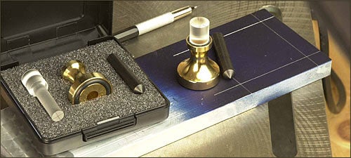

Marking the exact center with a center punch can be tricky; I have to use a magnifying lens to get the punch at the intersecting lines. That is the beauty of Method #3; you get at least a small punch mark when you locate the center. I bought a fancy (and expensive) optical center punch from Lee Valley tools, shown in the photo. With this you can locate the intersection of center lines with the optical cross hairs, then insert the steel punch to mark center.
You need a center punched dimple to drill into any metal object.
