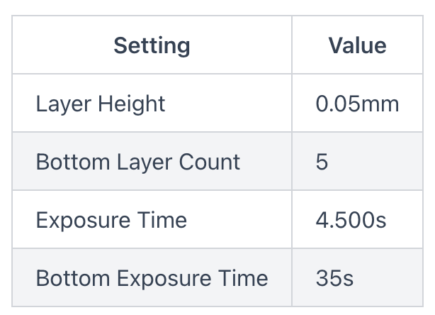

Printer Settings
I used two different resin colors for the chassis, the top and bottom cases are printed with white resin, and the middle chassis is printed with yellow resin to which I added some resin dye to get a darker shade or orange-yellow.
Following are the settings that worked well for me for Elegoo Saturn 2 8K printer.
I used the free version of Chitubox.
