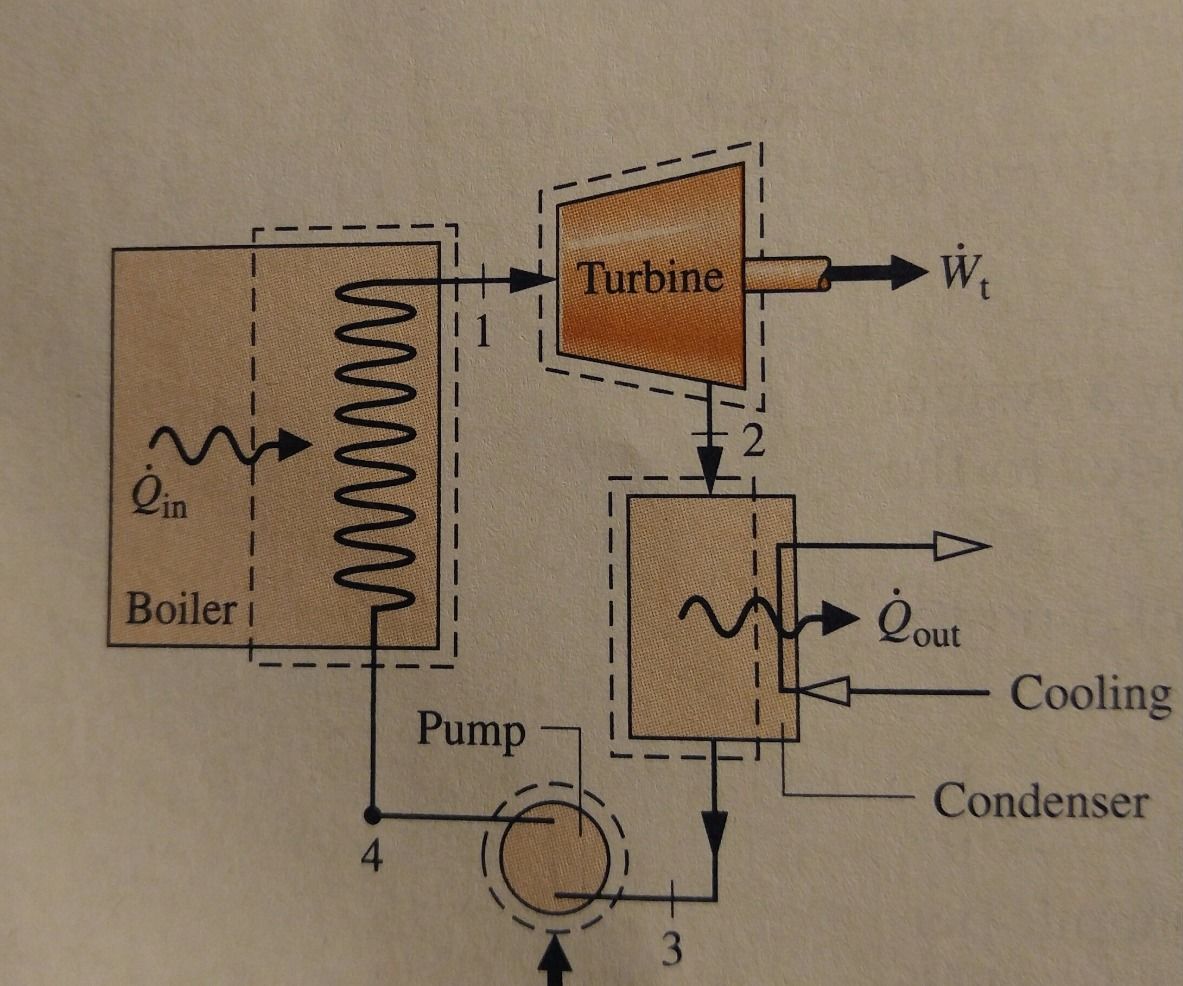

The picture shown above is a correct table.
Step 3: Finding State 1 Properties
Now you will begin to record the remaining properties for both states. Since this problem involves a steam turbine, state one must be superheated to avoid mechanical failure. This helps you find your properties.
The first step is to complete the State one properties using the following steps.
- Locate your state one pressure value in the metric superheated tables in the thermodynamics textbook. The picture above shows the section you need.
- Identify which row lists properties for your given temperature.
- Record enthalpy and entropy values corresponding to your temperature.
The above picture shows completed state one.
