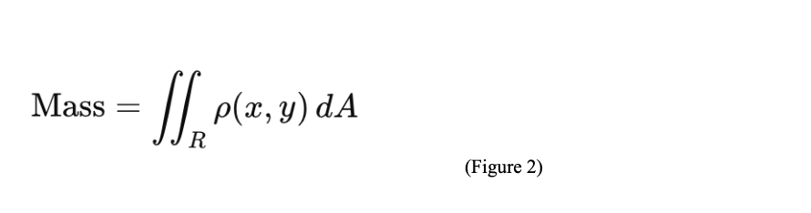

The next step involves double integrals. If density is constantly changing, we cannot use area times constant density. Instead, we split the object into lots of tiny shapes and use double integrals to sum them. The equation below is used to find the total mass with an inconsistent density.
In this equation, R is the region or shape we are looking at, dA is the tiny piece of the object, and p(x,y) is the density at dA. Once we have the total mass, we can utilize the moments we found earlier. This formula will be different as we are using a non-constant density.

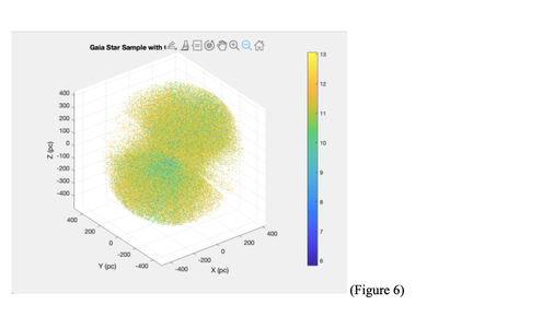

Finally, I created a 3D scatter plot. As the stars get brighter, the dots get darker. The red dot shown in the plot is my calculated center of mass. I utilized AI to add nice, professional comments to my code, and I was done right??

After this initial data and plotting, I decided to add more data. Going through the Gaia website, which contains all data collected by the probe, I noticed that it contains velocity data. The bulk motion of each star will help create a more accurate plot of the stars and show which direction the COM is moving. This new data also contains 500,000 stars compared to 275,000 in the previous plot.
