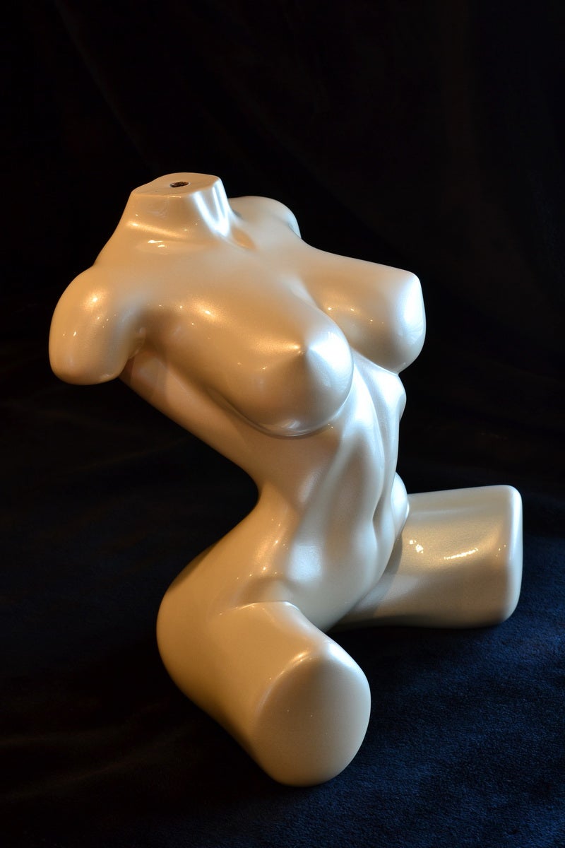

Step 1: Process Your Model
Before you import your model into 123D Make, be sure to think about any ways you might need to support it while working on it. In my case, I knew that I needed a way to "hold on" to the model without actually touching freshly painted parts, so I booleaned a 3/8" hole into the core of the model in my 3D software before exporting it to 123D Make. This hole was then laser-cut into each layer (far easier than drilling it later) and when the layers were glued up, it allowed me to insert a 3/8" steel rod to act as a "handle" while working on the model (especially painting).
Once you import your model into 123D Make, the first thing you'll probably want to do is to choose the material and thickness that you intend to use. Knowing the thickness of the material you plan to use is *critical* in order to get the best (non-distorted) results. Next, you'll want to set your scale - overall dimensions of your final model. Next choose the best layer orientation for your model - one that will minimize or eliminate unconnected parts or leave you with small or unsupported structures. When you are happy with your results, export your templates and either cut them out yourself, or have a laser-cutting service do it for you.
Step 2: Assemble the Core
If you send your templates out and have them cut, you'll want to understand how the layers align with each other. Each layer you receive (most of them) will have four pinholes. These pinholes are for aligning the layers. The "trick" is: Not all of the holes are used from layer to layer. You will use *two* holes to align any two layers, not all four. The two pinholes that aren't used on one layer, will be used on the next layer up.
For Example:
Say you have four layers - A, B, C, and D. Each layer will have four holes - roughly in the 3, 6, 9, and 12 o-clock positions.
Layer A is on the bottom - it may only have two holes - but let's say it has four. When you place layer B on top of layer A, only two holes will align correctly with the two of the holes in layer B. Let's say it's the holes at the 12 and 6 o-clock position. Spread glue on the bottom of layer B, and using pins at the 12 and 6 o-clock positions, align the layers and press them together.
Now, when placing layer C on top of layer B, the alternating set of holes will align - the 3 and 9 o-clock positions will be your reference points.
When you place layer D, you will again use the 12 and 6 o-clock positions, etc.
This should be a bit clearer when you have your parts in front of you, but it escaped me until after I had several layers glued up - so it's worth noting.
Between each glue-up, I would put a board topped by a 5-lb weight on top of the stack to hold it all tightly together until that layer dried (about 20 minutes between layers). I don't recommend building separate stacks and gluing them together - they may be hard to align, or have a slightly different warp to them and not glue up tightly.
The final core is pretty tough - but I wanted to make it a lot more robust and make it easier for the body filler to bond to it, so I coated everything with clear urethane.

Step 3: Filling and Smoothing
There's really no way to sugar-coat this part. Filling and smoothing is a bit on the tedious side. What I was doing was mixing up small batches of filler, smushing it into the cardboard core, smoothing as much as I could before it started to harden, and then following up with Sureform-type rasps while it was still soft. Once everything was filled, I started focusing on the smaller dips and crevices - adding thin layers of body filler, letting them cure, and sanding them down. I always used the edges of the cardboard layers as my landmarks - trying to change them as little as possible.
I tried a few types of filler and found that the Evercoat brand was the smoothest and easiest to work with. BTW - All of your filler should be mixed and used with plenty of air circulation - outside if possible - and it'd be a good idea to wear an organic vapor respirator. You don't HAVE to, but I prefer to NOT smell polyester resin for the rest of the day - it's one of those smells that seems to get into your nose and lingers even when you're nowhere near the stuff.
Early on, I considered using spray foam to fill the voids - and I think that's a possible solution - but I wanted something that was going to be *very* smooth and *tough* - so I went with body filler. I'll try foam next time ;)
The first few layers were just for overall shape - the whole process is one of refine, refine, refine - don't expect it all to be smooth in one step and you won't get frustrated. Take your time, keep moving around the model, don't get focused on one area. Eventually, you'll only have small imperfections to fill - and that's the job of filler primer ;)

Step 4: Priming and Final Smoothing
The first coats of primer are a lot like the first coats of body filler. I shoot heavy coats of primer and don't really care about runs or sags. I want a heavy coat of primer so I have a lot to work with as I sand most of it away :) Be aware of how the primer you're using cures - I use catalyzed primers because they cure well even when they're stupid-thick. Rattle-can primers have to be used more carefully to get a good thickness build up without making a gummy mess.
Again, it's all about refine, refine, refine. I sprayed something like six coats of primer (spray two, cure, wet sand, spray two, cure, wet sand, etc)
In regards to sandpaper: Most of the sanding I did was with 1"x1" squares. I cut 1"x3" long strips, then fold them in thirds. This gives you three fresh surfaces to work with. Always let the sandpaper do the work, don't use too much pressure. You want the paper to glide over the high spots and take them down - using too much pressure can scar the surface, and will force the paper INTO the low areas which pretty much defeats the purpose of sanding. A good way to judge pressure is to rub your finger quickly along the inside of your wrist using the pressure you think is good - if you don't generate a lot of heat, that's about right.
Once you think you're all smooth, it's time to focus on high spots, rough spots, and pits. I use semi-cured primer as a filler for the pits I find - it works better than glazing compound. Sit by a strong source of light and carefully pick out the problem areas - I mark them with a pencil and a visual code that lets me know what the problem with that area is.

Step 5: Painting
I have to admit - I was conflicted with the idea of painting - I kind of like the look of the primer.... but in the end I went ahead and painted it with a three-stage finish.
A three-stage finish is one that consists of a base coat, metallic coat, and a clear coat. The finish I chose was a pearl white from a 2002 Cadillac. I don't have pictures of the finishing process - mostly because it's a fairly frantic process and I was working under less than optimal conditions (windy, cold) but overall I'm pretty happy with the finish.
At this point, I'm probably going to pull molds off this model and do some castings - maybe some cold-cast bronze, resin, ceramics ... even wax(?) Sounds like another Instructable to me :)
So, would I do it again? I think so. It's a lot of work, but I think that next time I'll be able to streamline the process and probably do it in about half the time. It seems like you always get better results the second time around :)
