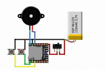

Soldering:
Just follow the plan when soldering. You do not have to pay attention to the polarity of the piezo element. Leave enough cable for the speaker, switches and power connection.

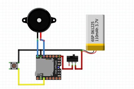

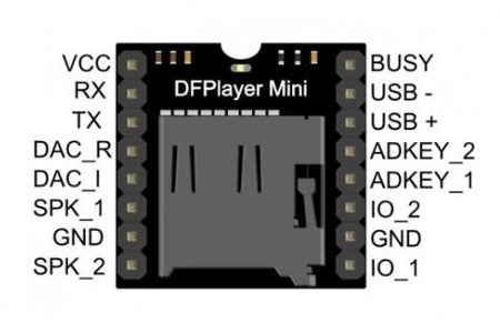

Actually, we only need one push button between IO2 and GND to switch to the next mp3 file. You can also solder another push button to IO1 and GND, with which you can go back in the file list.
Further it says about the two connections in the data sheet:
"IO 1: Short press to play previous (long press to decrease volume).
IO 2: Short press to play next (long press to increase volume)."
With both switches you have a fully functional mp3 player!
