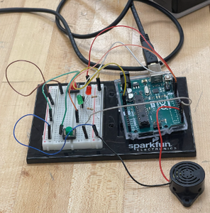

Step 1: Assembling the Right Components
With the Arduino and Breadboard I have 10 wires, two buttons, two LEDs, two 330s resistors, and a speaker.
  1. Put wires in the Arduino sections labeled, 13, 12, ~11, Tx>1. In the schematic with TinkerCad these are the wire colored, 13 = Magenta, 12 = Red, ~11 = Green, Tx>1 = Light Blue. Put these in their spots on the Breadboard.
  2. Then the light- blue wire connected to the Arduino, in the spot labeled: GND, is in the negative column of the breadboard.
  3. Connect the two resistors to the negative column. Then place the LEDs where those resistors are.
  4. Connect speaker to Breadboard, red wire to Arduino 2, black wire to Breadboard negative column.
  5. Connect the buttons to the same row as 13, and Tx>1.
  6. Then wire buttons to another negative column, and connect that negative column to the other.
  7. Then plug in the Arduino C++ code.
If you would like a reference, here it is...
https://www.tinkercad.com/things/4A4j3m7MGaj-brilliant-duup/editel?sharecode=kOjcmtU-iPkB7mtJ9cRY8_inDQo5Ythsy8wzytie7ZE

How this works is that the given code outlines the pin assignments and setup for a game involving two players. The pins are assigned to buttons for each player, LEDs for indicating player turns, and a buzzer for sound output. In the setup, the pins are defined as input or output. The main loop of the game involves waiting for both players to initiate the game, and then the game starts when either player presses their button. Depending on which player pressed their button, the corresponding LED will blink, and the opposing LED will turn off. The game will loop until both buttons are released and the process of waiting for both players to press their buttons will start again.
Step 3: Finallizing Everything
Once finished, make sure that you upload the code through the Arduino with a laptop and play the game. Enjoy!!!
