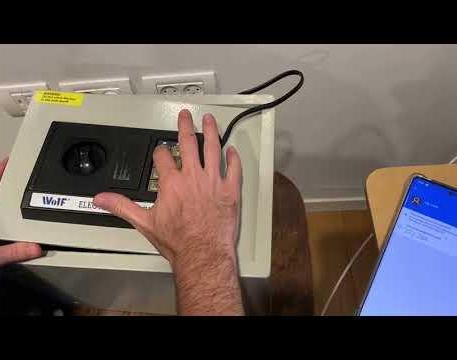

This project is based on a previous one I published, where I took an old safe and replaced its control board with an ESP8266 D1 Mini to make it into a modern OTP safe.
Time-Based One-Time Password (TOTP) Smart Safe : 7 Steps (with Pictures) - Instructables
This time, I'm adding a Fingerprint sensor to allow for a second method to unlock the safe, including a way to enroll new fingerprints.
The plan is to have the fingerprint sensor work in parallel to the keypad, meaning that one can open the safe using the keypad's OTP or using the fingerprint.
This gets interesting when you think about how to enroll new fingerprints. Enrolling means "teaching" the safe a new fingerprint which is authorized to open the safe. The fingerprint sensor can store up to 127 signatures, and then tries to match the fingerprint it is presented with, with any of the enrolled ones. To enable enrollment, one must first unlock the safe (either using a previously enrolled fingerprint or using the OTP).
Once unlocked, there is a 10 second window during which the fingerprint's LED shows a purple breathing pattern. If during these 10 seconds the user will type (using the keypad) a number between 1-127 followed by A or B, then the controller enters the enrollment process, and will store the enrolled fingerprint in slow 1-127 according to the input. To enroll, the user needs to place the finger on the fingerprint sensor twice.
The fingerprint sensor I used is an R503, which is a capacitive fingerprint sensor, as opposed to optical ones.
My intention was to replace the safe's key cylinder with this fingerprint sensor, but the inner thread diameter of the sensor is 23.5 mm, which is 5.5 mm larger than original key cylinder. I ordered it anyway, assuming that I can find a way to make it fit. Luckily, it turns out that the outer diameter (25 mm) is an exact fit to the safe's plastic cover, so the sensor sits very firmly in place without needing to fit it all the way into the door.
Step 1: Replacing the Cylinder With the Fingerprint Sensor
To disassemble the cylinder, you simply need to unscrew the back side of the cylinder (from the inner side of the door). This removes the mechanism that allows the key to release the lock. Then there is another washer that needs to be unscrewed, and the cylinder can be removed. I'll need to remove the front panel for easy access.
The fingerprint sensor doesn't fit into the door like the cylinder (23.5mm vs. 18mm), but there was enough room in the panel since the fingerprint sensor needs to be further out than the lock. Once secured, the wires can neatly go inside threaded through the original cylinder hole in the door.
