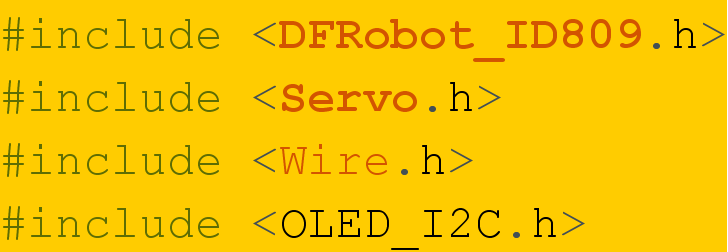

Step 6: Uploading the Program
Open the program on Arduino IDE. Once it is open, compile the sketch to see if it is clear of error and upload it. Make sure you have all the libraries download before you upload the program. These are the link to the libraries that are not on the libraries manager. (DFRobot_ID809, OLED_I2C) After uploading the program, the OLED screen should turn on and display "Fingerprint Smart Door Lock." After that, the screen should display a message asking you to scan a finger to set it as a master user.
