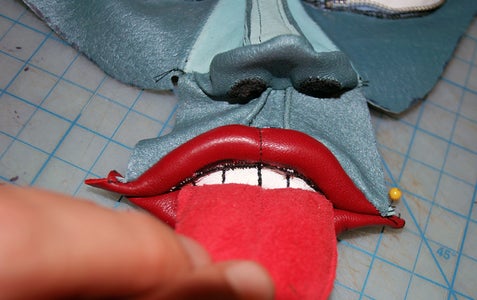

Step 1: Lower Nose to Upper Lip
In the last part of Kali's Top Face, I sewed the teeth to the upper lip with a short, tight zig-zag stitch. Using black thread to sew white leather means that every single skipped stitch showed, even after stitching twice! I used the tip of a black Sharpie pen to color over the gaps. This made the seam look cleaner. It also meant I accidentally got a little Sharpie on the upper lip. Oops. Luckily, permanent marker is not that permanent. I can fix her lip later.
Pro tip: rubbing alcohol helps make Sharpie pen marks fade. So does time and sunlight and laundering.
I pinched the upper lip together at its midpoint to check out the fullness. It was a little flat, but I figured I could add some more padding after the lip and nose areas were joined up. I turned the face parts to the back sides, pinned the upper and lower nose parts together, and sewed them using a straight stitch and a 1/4" seam allowance. Once the seam was trimmed down to a scant 1/8", I turned the face right side round to check out the fit. It needed a little thread trimming at the nostrils, but it looked pretty good!
Step 2: Lip Plumping and Rigging
I turned the face around to the back side to deal with the lip padding. The sculpted ethafoam I used for the basic lip shape wasn't adding enough fullness. I cut a piece of heavy yarn to size, machine sewed the ends of the yarn to prevent fraying and pinned it to the inside center of the lip.
I threaded a hand needle with heavy duty thread and whip stitched the lip seam allowances over the yarn. Instead of pulling the thread tight with each stitch, I kept the thread a little bit slack. This gave the yarn some room to move around and helped keep the lip from looking too rigid. With extra padding, the upper lip looked much better, so I moved on to the lower lip and tongue.
After pinning the corners of the lips together from the front side, I turned the face over and pinned the bottom edge of the teeth to the top edge of the lower lip. The tongue would hide the bottom edge of the teeth, so I didn't have to worry about making pretty stitches. I turned the face over again, checked the pin placement from the front side, and whip stitched the teeth to the lip.
You may notice that I spend a lot of time going back and checking the fit from both the front and the back sides. This is because these shapes are confusing! And when I sew, I am frequently working inside out, backwards, and upside down. It is so very easy to lose track of where things go. Checking helps remind me where I am in the process.

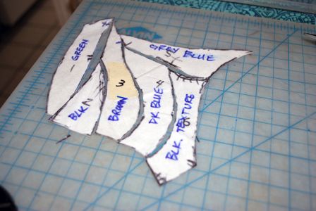

Step 5: Neck Patterning
Before getting started on the neck, I checked out Kali's face over the mannequin to test the fit. Everything looked good, so I moved on to the neck pattern.
My first step was to label all the pattern pieces with numbers so I could keep track of them!
After numbering the pieces, I double checked the pattern lines and drew in cross marks at the join points. I unpinned each piece, trimmed along the drawn lines, and laid them out in order on the cutting mat.
The center neck piece was originally drawn as two pieces (see picture #7), but I decided to cut it as one piece. By this point, I was tired of putting together face parts and anything I could do to cut out a step sounded great. I re-labeled the piece as 7 (instead of 7 and 8) and renumbered the remaining neck patterns accordingly. Once all the pieces were trimmed along the lines and laid out in place, I chose my leather colors and wrote them down on each pattern.
Pro tip: turning two pieces into one is a classic time-saving method in pattern making. The fewer seams you have to sew, the less time it takes to get finished.

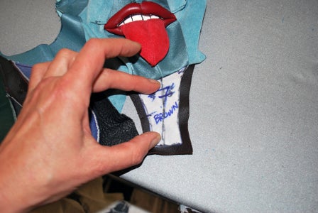

Step 8: Left Neck in Leather
My final step before moving on to the left and back neck was to sew the left cheek "point" to piece #7 (see picture #1). I then sewed in piece #10, which covered the left jawline, and piece #8 which covered the front neck. Both of these pieces were sewn with interior 3/8" seams that were trimmed and flattened with the wooden spoon. Putting these seams on the inside helped emphasize the jawline and indentation under the chin.
Neck pieces 9 and 11-13 were sewn with exterior 3/8" seams, trimmed to a scant 1/8" and smoothed open with the wooden spoon. I wanted the outer edge of the neck to have the same type of seams I was using on Kali's body so the pieces would blend together nicely.

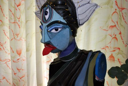

Step 9: Facial Fitting
Once all the face pieces were FINALLY sewn together, I planned on pinning it around the mannequin to keep it in shape. There were many more Kali body parts to construct, and I had no idea how long it would take to make them. In the meantime, the face could hang out on the form and stretch into shape.
I started by pinning the third eye in place below the hairline. Kali's face looked remarkably creepy, but that was simple to fix! I tucked the chin leather into place, pulled the neck pieces around to the back, and safety pinned the edges together in the center back. While I was fitting the face in place, the tiny office clips I was using to hold the shoulder seam closed kept coming unclipped, so I replaced them with safety pins too.
I moved back to the front and smoothed out the sides of Kali's eyes, and then pinned those into place. Much better! She might still look like a creepy muppet, but it was a very well-fitted and constructed goddess muppet.
Perfect.
