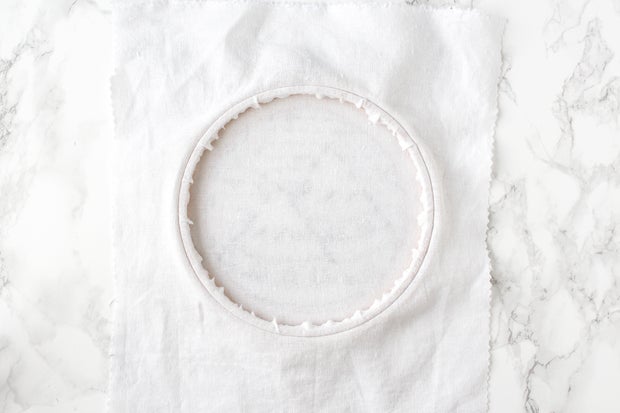

Once the fabric is in the hoop and the embroidery design is centered and taut, flip the hoop over and trim all around the outside of the hoop using pinking shears.
Here's a quick video of me trimming:
Typically, I like to rest the edge of my pinking shears against the hoop and that cuts the fabric at the perfect length.
Leave about 1/3-1/2 inch of excess fabric. Don't cut the fabric edges to be longer than the height of the inside edge of the hoop. This will cause the excess fabric to lay against the fabric in the hoop and be visible.
Apply Fabri-Tac all around the outer edge. Go around the hoop, folding the fabric over and pressing it into the inner ring of the hoop. Go around the hoop one more time, pressing as you go, holding the fabric briefly to make sure it stays adhered.
Go back around and apply excess glue to any spot that looks loose.

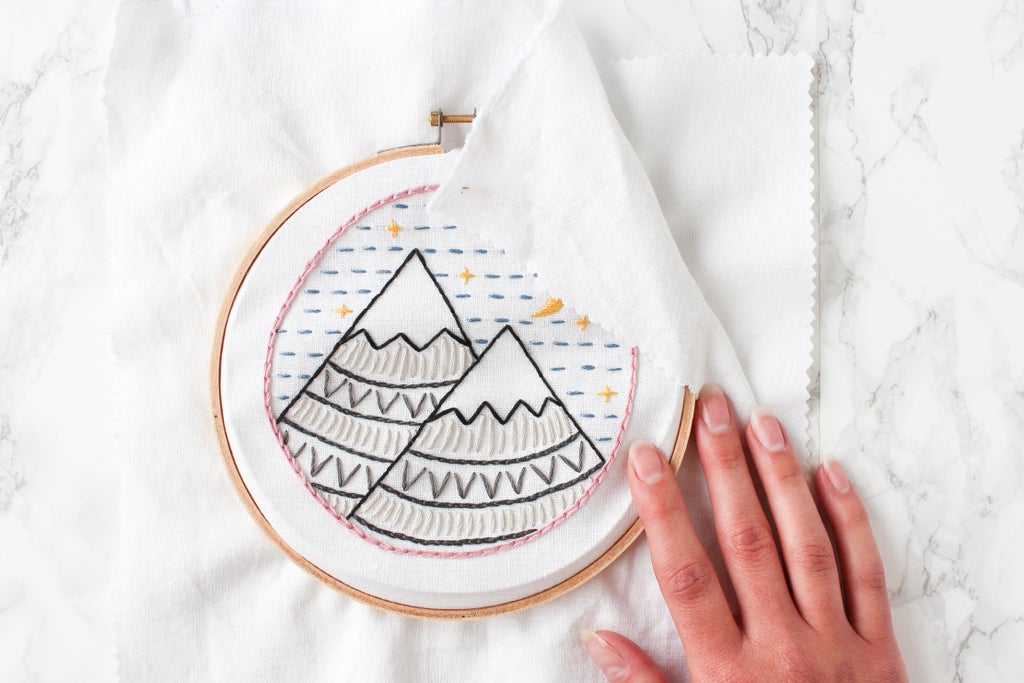

Place a piece of fabric under the fabric with the embroidery on it and hoop both pieces of fabric together.
Pull on the backing piece of fabric first to make it tight, and then focus on getting the embroidered fabric into position.
Trim the backing fabric with the pinking shears and glue it down.
Repeat with the front fabric and you've got a nicely backed hoop with little fuss. :D

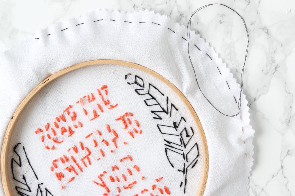

Instead of trimming the fabric very close to the hoop, trim all around the hoop with pinking shears leaving between 1.5 - 3 inches of fabric. How much fabric you leave all depends on the hoop. I tend to leave about 1.5 inches for a 6 inch hoop, and 3 inches for a 10 inch hoop.
Double thread a sewing needle with enough thread to go all the way around the cut edge. Sew all around the edge using a running stitch. Sew about 1/4 inch away from the edge.

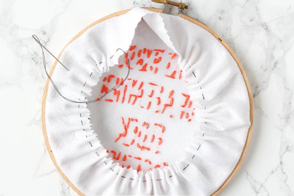

Once you've gone all the way around the fabric, pull on the thread to gather the back of the hoop.
Adjust the gathers with your fingers and secure the gathers with a few tiny stitches. Then knot your thread and trim the excess.
Be careful and don't pull too hard - it's easy to pull the knot right through the fabric!
