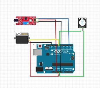

What does it do? When the Infrared diode sees the flame, it sends the digital out DO to also, the level of the flame is represented with Analog output
Step 1: Connection
DO = D2
BUZZER = 8
DO NOT USE SERVO

Step 3: TESTING
TAKE SOME FLAME AND OPEN THE SERIAL MONITOR TO CHEAK THE PROJECT
