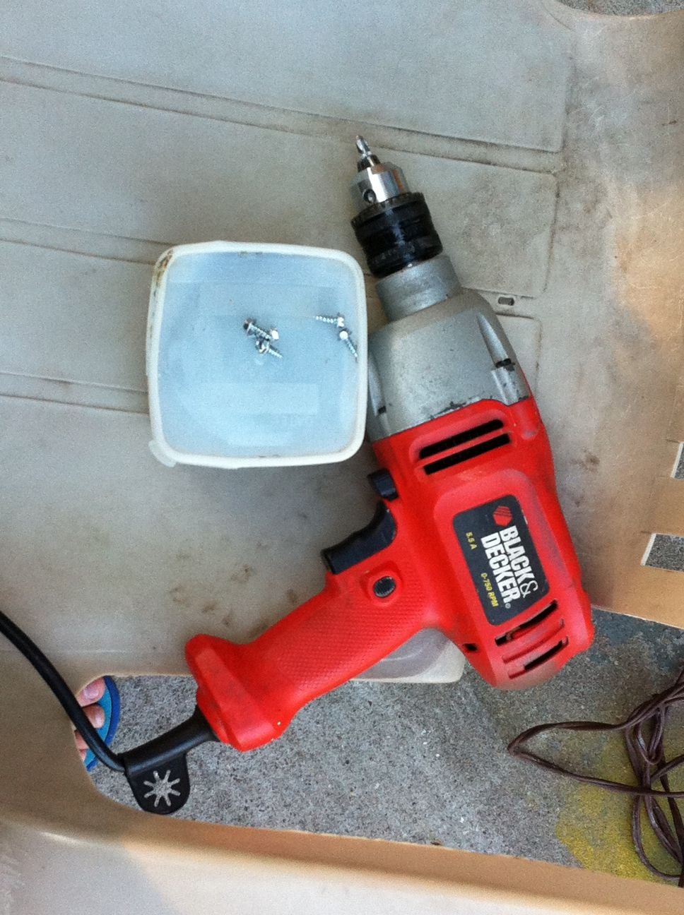

I used self tapping screws to hold it all together.

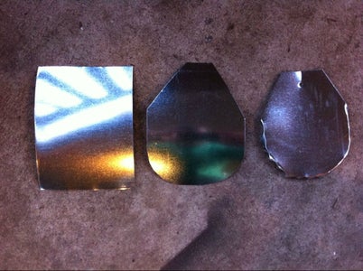

Step 2: Scales
The scales are also made of tin. Homedepot/Lowes sell 15-20 ft rolls of it for the gutters.
I cut out rectangles, trimmed them into a tear shaped pieces and bended the edges with pliers to give them dimensions.
Next, the scales were screwed in to the body with the self tapping screws.

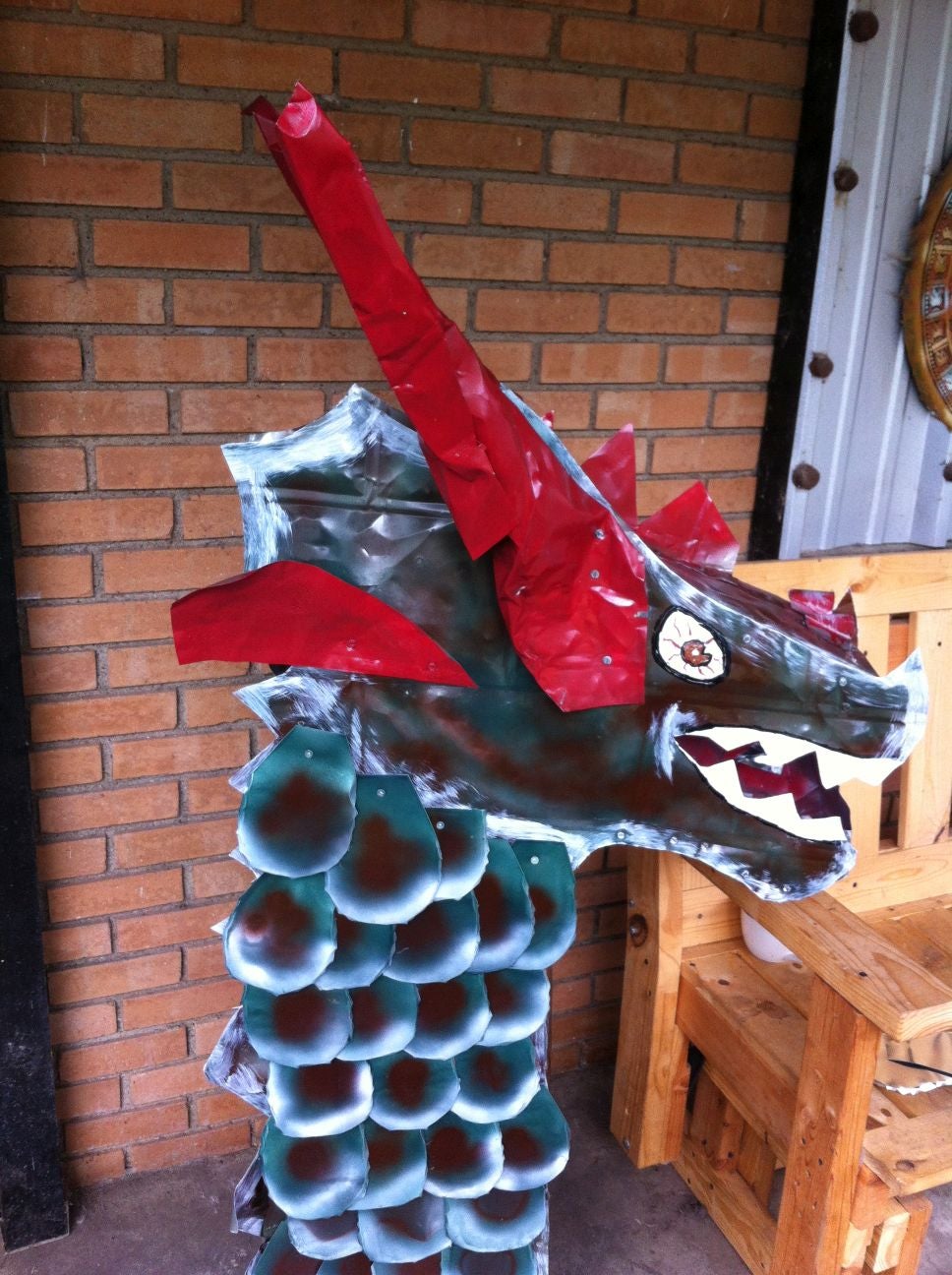

Step 3: Body
Paint is next. My lovely wife painted the head/neck green. Each individual scale was painted with green, brown and silver.
I added tin horns, ear flaps, nostrils and eye lashes ( it's a girl dragon) and she painted them red. She drew eyes, colored teeth, and outlined other features.

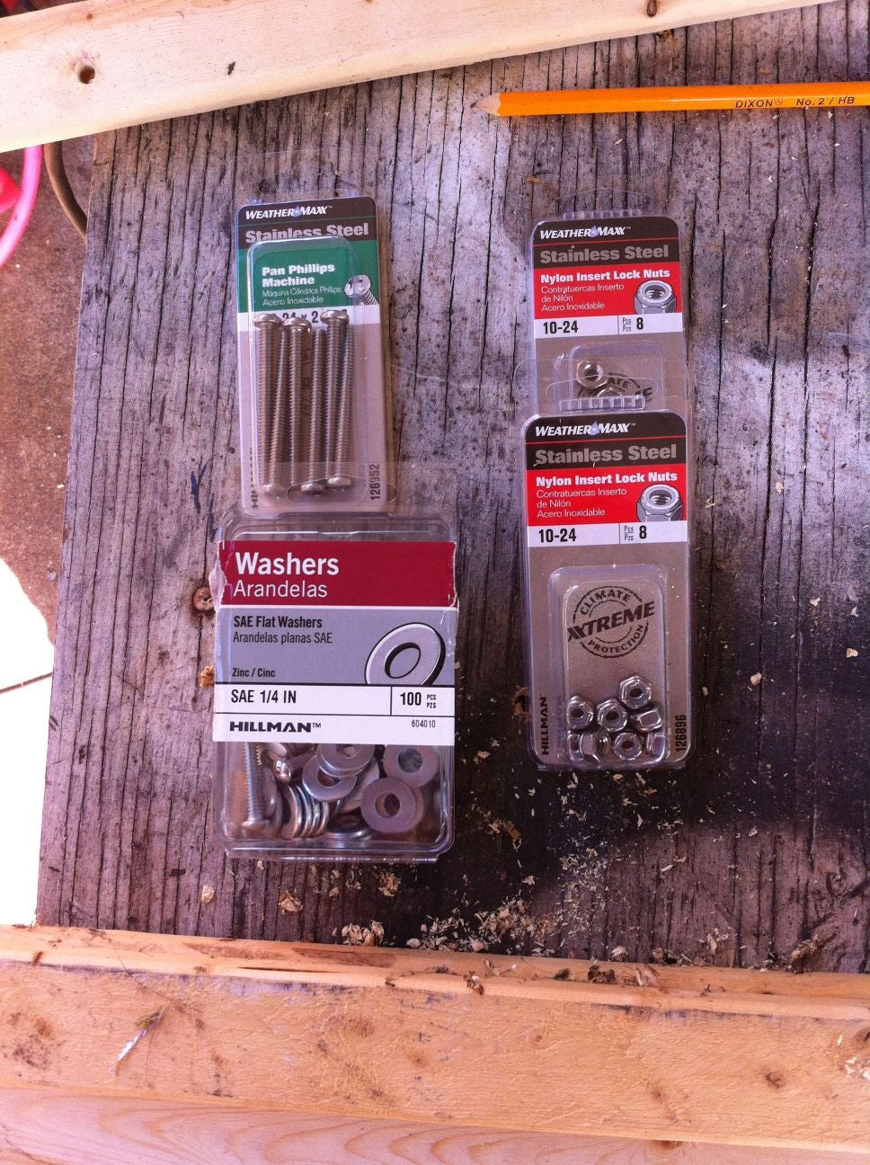

The wings are made out of 1 by 2s connected with two inch bolts with washers.
