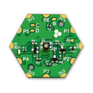

RGB LED (H01R0x)
H01R0x is a smart RGB LED module based on Cree CLVBA-FKA RGB LED and STM32F0 MCU.

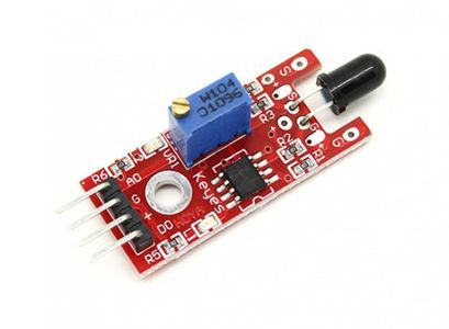

Flame Sensor:
The flame sensor is very sensitive to IR wavelength at 760 nm ~ 1100 nm light.
Analog output (A0): Real-time output voltage signal on the thermal resistance.
Digital output (D0): When the temperature reaches a certain threshold, the output high and low signal threshold adjustable via potentiometer.
Pins:
VCC...... Positive voltage
input: 5v for analog 3.3v for Digital.
A0.......... Analog output
D0......... Digital output
GND..... Ground

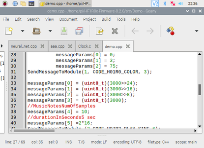

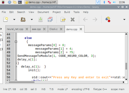

You can use a Geany to modify the codes. Geany is a powerful, stable and lightweight programmer's text editor that provides tons of useful features.
Add your one-time initialization code before the main.
Add your Messages inside the main and Initialize the input(flame sensor)

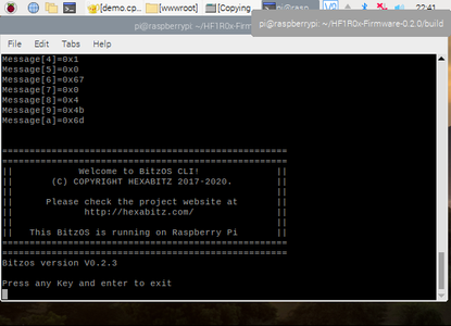

How to compile the repository
make
How to run the executable
./hexabitz-demo
