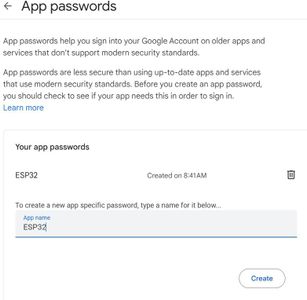

Step 4: Steps to Create a Gmail App Password
  1. Log in to Your Google Account:
  2. Go to Google Account Settings.
  3. Use your Gmail credentials to log in.
  4. Enable Two-Factor Authentication (2FA):
  5. In the account settings, navigate to "Security".
  6. Under "Signing in to Google", enable 2-Step Verification.
  7. Follow the prompts to set up 2FA using your phone or other methods.
  8. Access the App Password Section:
  9. After enabling 2FA, return to the "Security" section.
  10. Scroll down to "Signing in to Google" and click "App Passwords".

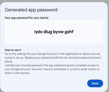

  11. Generate an App Password:
  12. Choose an app and device from the dropdown menus.
  13. For example, select "Other", and name it something meaningful, like "ESP32 Project."
  14. Click "Generate" to create a 16-character password.
  15. Copy the Password:
  16. A yellow box will display the App Password.
  17. Copy this password and use it in your ESP32 project code where sender_password is required.
  18. Secure the Password:
  19. Store it in a safe place. Do not share it or expose it publicly.
