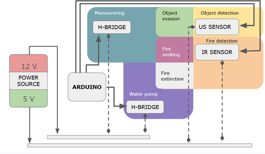

B. CIRCUIT
1.Requirements
The electronics is the part that is responsible for the behavior of the robot. To accomplish the required range of functionality, there are some requirements to be met and accordingly the electronics are implemented. A list can be made:
  1. Smoke detection: The robot needs to be able to detect the presence of smoke from a certain distance.
  2. Flame detection: To locate a fire, a tool is needed to measure the flames.
  3. Object evasion: Evasion of object in the way is a requirement.
  4. Mobility: Our robot needs to be able to move around.
  5. Autonomous: There can be no interaction between the robot and bystanders.
  6. Water propulsion system : A pump is required to enable a water jet that can be activated once flames are detected.
2.Design process and consideration of components :
This functionality implies the design of five electronic subsystems, each dedicated to a specific task. These subsystems must be carefully integrated and managed to ensure cohesive operation. For instance, the system must be capable of activating the pump when the flame detector surpasses a predefined threshold, while simultaneously managing mobility and object evasion. Such coordination is critical for the robot's proper functioning.
I. Flame detection - Infrared sensor
As an infrared sensor, we selected an infrared photodiode, model WL-TDRB THT Photodiode Round Black, which is suitable for detecting light in the infrared spectrum.The WL-TDRB THT Photodiode is optimized for detecting infrared radiation, specifically within a wavelength range of 750 to 1100 nm, with peak sensitivity at 940 nm. It exhibits a typical photo current of 9 to 30 µA under standard illumination. It has a viewing angle of 45°, the photodiode allows for targeted detection.
Due to several factors, an electronic circuit was required to interface the photodiode with the Arduino. This circuit is essential because the photodiode generates a very weak current that is difficult for the microcontroller to read directly. The circuit amplifies this signal using a BC548 transistor, converts it into a measurable voltage, and conditions the signal to make it more stable. Additionally, it polarizes the photodiode to ensure optimal detection and protects the Arduino by limiting the signal to a safe voltage range.
A photodiode operates in photoconductive mode, meaning it generates a current proportional to the intensity of the light it captures, provided it is appropriately polarized. In forward bias, the photodiode allows electrons to move freely, facilitating the measurement of the signal generated by light absorption. Two resistors were added, one at the emitter of the transistor and the other at its base. The values were chosen by testing several resistors until achieving effective detection. A 200 Ω resistor was placed on the emitter to stabilize the transistor's gain through negative feedback and so ensuring the circuit's stability.
A 200 kΩ resistor was added to the base to properly polarize the transistor. This value provides sufficient base current to keep the transistor in its active region without risking saturation, allowing for linear amplification of the signal produced by the photodiode. The circuit is shown in figure 5.1.
II. Object evasion - Ultrasound sensors :
The HC-SR04 ultrasonic sensor was used for obstacle detection. It operates by emitting a 4 kHz ultrasonic pulse and measuring the time taken for the pulse to reflect off a surface and return to the Echo pin. This sensor works under an operating voltage of 5V and have an energy consumption of 0.075 mVA/hrs. The output of the sensor is digital and knowing that the time required for the signal to make a round trip corresponds to the sensor output, the distance separating the obstacle from the sensor can be calculated as follows :
d = 0,5 x (t x c )
Since the operating voltage of this sensor is 5V this device has been connected directly to the Arduino board without intermediate circuit as shown in the figure 5.2.
III. Smoke detection - Air quality sensor :
MQ-2 Air quality sensor is chosen and the and the main reasons are its capability to detect more than one type of gas and the compatibility with the Arduino. Additionally, a potentiometer was included, allowing us to calibrate the alert threshold. During multiple tests to fine-tune this device, we occasionally observed erroneous readings. To address this and obtain more reliable results, we decided to eliminate white noise by implementing a moving average technique. This approach involves calculating the average of values within a sliding window, effectively reducing rapid variations caused by noise.
IV. Mobility - DC motors :
For propulsion of the wheels, different types of motors our possible, stepper- and DC-motors being the obvious ones. Because of the weight of the robot (due to water in reservoir,...) a powerful 12V DC motor was chosen, preferring continuous strong movement over accuracy.
After selecting the type of motor, we considered how to control these motors to enable the robot to move in the desired directions, including turning in any direction and moving in reverse.
To turn the robot in a specific direction, the wheels on the opposite side must rotate faster than those on the side toward which the robot is turning. This requires varying the current supplied to each motor depending on the wheel’s position on the robot. Additionally, to enable the robot to move in reverse, it is necessary to reverse the polarity applied to the motors, thereby changing the rotation direction of the DC motors.
To address these requirements, we decided to use H-bridges, which allow control of both the speed and the direction of the motors’ rotation. The circuit of this subsystem can be seen in figure 5.3.
V. Water propulsion system - Pump :
For the water jet system, a peristaltic pump was selected due to its reversible operation, allowing fluid to be pumped in both directions. The pump is powered by 12V motors connected to H-bridges, which enable polarity reversal at the motor level. This design allows the motor to rotate in the desired direction, effectively controlling the flow direction of the pump but also to control the water flow.
This bidirectional capability is particularly advantageous, as it enables us to refill the water reservoir without the need to physically remove it from its position. By reversing the pump's operation, water can be drawn into the reservoir directly, enhancing the robot's operational efficiency. We also added nozzles to precisely direct the water jet towards our target (the fire to be extinguished). The circuit of this subsystem is shown in figure 5.4.
3.Final circuit diagram
The final circuit can be found in the Figure 5.0 . There all connections and hardware can be observed, as connected to the Arduino for optimal communication. Before assembling the full circuit, it is recommended to test every element separately first. The next step is then to test the different subsystems if they are functioning correctly. Videos of tests of the different subsystems are provided in annex. A list of the exact components used is given in the section 'Supplies'.

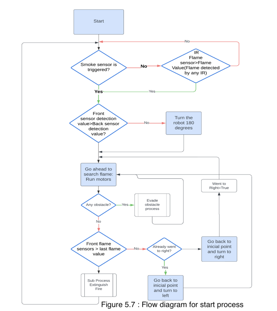

C. Code and flow diagrams for sub systems:
The flow diagrams illustrate the sequential actions undertaken by the robot during fire extinguishing operations. The process begins at a designated starting point, where the robot is activated upon detecting smoke or flames. It then navigates toward the source of the fire while simultaneously avoiding obstacles, ensuring an efficient and safe path to extinguish the flames.
This can be seen in the figures 5.5, 5.6 and 5.7.
Step 6: Integration Guide
Synthesis.
The complete construction of the system is centered around our microcontroller board, the Arduino UNO. As the center locus for the processing of information and the relaying of instructions based on our program we need to define how each subsystem will operate and be connected with these constraints.
Motion.
As stated before, the motion of our system is given by a set of four DC motors connected in parallel to an H-bridge circuit which act as its control element, while the four wheels are mounted to the frame of our robot by the connection of smaller plaques to the motors and the whole frame.
The H-bridge is a component with 6 pins allotted to its control:
  1. Two pins are allotted to the manipulation of the load fed to the system, on a percentage basis.
  2. Four binary pins are allotted to the control of the direction of the load to the two output terminals on each hemisphere.
Mounting the wheels to the frame to later connect them to their respective hemisphere in the H-bridge will constitute the integration of the mobility element for our system.
Maneuvering.
The components in charge of allowing for a maneuvering action are a set of ultrasonic sensors. These are placed in a configuration facing off to the sides, so the emitter and receptor that make up the sensor can be better used to detect and avoid any obstacles through defining a minimal tolerance of time for the return of the emitted signal.
The connection to the arduino is done through two pins of signals (output and input) and the necessary connections for energy allowed in the 5V grid.
Fire detection.
The components in charge of allowing for the detection of active fires is done through a spectrum analysis with the focus of trying to identify infrared traces of infrared radiation, a common emission of flames.
The integration of this component was made through the construction of a circuit plaque connected to an NPN transistors in order to define a current control as the current tends to sink in the collector in these types of transistors.
There is a set of four sensors connected to the central unit. Of these three are directed to the front and set up at different directions for maximum coverage while a redundant sensor is installed on the back to allow for the tracking of any flames in that blindspot.
The protocol used by the sensors to track and follow the origin of the reading is mainly to turn the whole system in one single direction before moving towards it until the reading of the front sensor reaches a level above a certain threshold.
Fire extinguishing.
The system responsible for the act of fire containment and eventual extinction works mostly on the principle of the following components:
  1. IR sensor (Front radiant.)
  2. DC motor (Pump.)
The DC motor like before is controlled through an H-bridge expressly defined for one particular functionality to control the flow of liquid through the pump. Be it for the fire propulsion or for reservoir refill.
This, in addition to the Ir sensor, allows for the propulsion of water once a fire enters the threshold of detection. And like before, the integration to the central unit follows the once stated previously for the motion and fire detection.

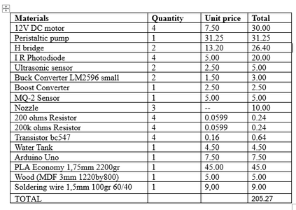

Step 10: Bill of Materials
This materials list outlines all necessary components for our project, with an emphasis on functionality and cost-efficiency. The inclusion of essential components like sensors, an Arduino board, and structural materials like PLA filament and MDF ensures the successful construction of the Smoke Detection and Fire Extinguishing Robot.
