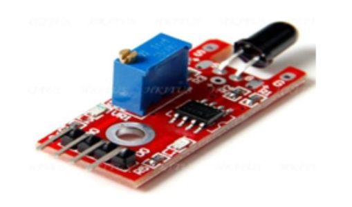

  • Flame Sensor (KY-026)

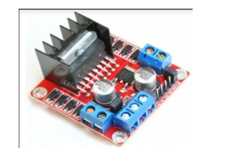

  •  Motor Driver Module(L298D)

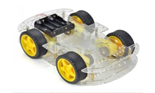

  • Chassis Car of DC 6V &120 mA

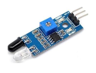

  • IR Sensor with  5VDC operating voltage & 20 mA supply current

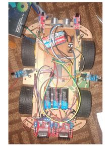

Step 1: Working
The potential of Fire Fighting Robot acts during extinguishing the flame, including:
·        Detection of fire
·        Wall avoidance
·        Extinguish fire
The robot detects the presence of fire through the sensor within a range of 20 cm to 100cm in designated areas. The sensitivity of sensing the fire is determined by calculating the distance from the robot to fire then the distance will be included in the PIC program. Robots will avoid barriers if there have any obstacles that occur during the process of detecting fire. The distance between the robot and the obstacle is determined through calculations included in the PIC program. The next step is that it will act to go to that place (fire) that has been detected by the sensor after move randomly and extinguish the fire with water. Focus on robot movement is based on the flat surface work area. All robot behavior is controlled by the Programmable Interface Controllers (PIC) as the main control system. PIC will control and give commands to the robot to sense the fire and obstacles. Assembly language is used as the language interface to be programmed in the PIC.
An ultrasonic sensor is used as a sense of sight for the Fire Fighting Robot. It is a sensor that will indicate obstacles in the path of movement. An ultrasonic sensor consists of a transmitter and receiver, transmitting to detect obstacles and receive signals through the receiver. The receiver will inform the PIC if there are obstacles in front of the robot. PIC will command the robot to change the direction of movement to avoid collisions with objects.
In detecting flame, the robot is equipped with the flame sensor mounted on a robot body. This sensor will respond to the presence of fire around 20cm to 100cm and give an interrupt to the PIC, next to giving instructions to the robot to move towards the flame. When the sensor has detected flame, the PIC will activate the pump for water out of the tank. Water will then be channeled to the spray nozzle through a rubber pipe. The robot will act by extinguishing flame using water until erased and return to the task of sensing a flame.
