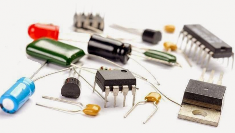

Step 1: Material Required
To make this project we need the following components:-
- Arduino Nano x 1
- LCD Display (16x2) x 1
- MQ-2 Gas Sensor x 1
- Flame Sensor x 1
- LM2596 Module x 1
- 10k Pot x 1
- Male -Female Berge Strips x 1
- LED
- Resistor (470E & 330E) x 3 x 2
- Buzzer x 1
- 2-Pin Slide Switch x 1
- DC Jack Socket x 1
- 470uf Capacitor x 2
- 7805 IC + Heat Sink x 1
- 1N4007 Diode x 6
- 2-Pin & 3- Pin Block Connector x 2
- BC547 + 2N2222 Transistor x 2 x 1
- 5V Relay x 2
- PCB (8"x 6") x 1
- 12V Adapter x 1
- 12-0 Transformer x 1
- Exhaust Fan (12v) x 1
[ Above links are affiliated link If you buy from the above links we get some bonus from them ]
