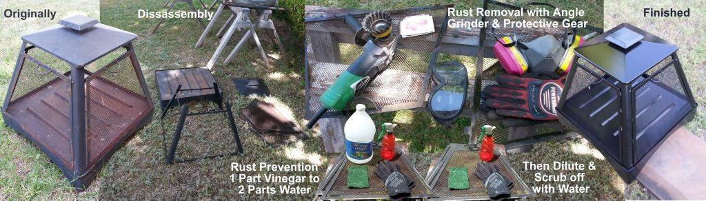

I bought this Fire Pit for $10 at a garage sale up the street. Wow what a deal! (& two days later the neighbor brings home a bbq pit with smoker for $20 same condition!) So here it is
Yard Sale find for $10!!!!!! Plus $8 for high temperature spray paint to total out for ~$18
1. Disassembly
2. Heavy Rust Removal using angle grinder with wire wheel attachement &/or wire brush
3. Rust Removal & Prevention with Green pad & Vinegar Mixture (1 part vinegar to 2-3 parts water, amount doesn't need to be exact)
4. Neutralize the Acid (vinegar) with water while scrubing with the green pad, air dry in the sun, (the metal should be slightly yellow) paint (in this case with high temperature paint) & voice (Lit. "Here" [it is-done])!

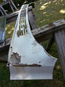

The next picture is of a 68 Chevy truck Cowl that I did 2 years ago. I've been doing the same process on my 60's & 70's cars & trucks since 2010, & the area I did it in hasn't rust at all. Vinegar is cheap, there are products out there that the auto places want you to buy, which are expensive & don't always work... like Rustolium? With a formula to help rust prevention, really? I tried quite a few of these products that will prevent rust, back in '05-'08 & they always seemed to fail. You got to do rust prevention before the rust eats away too much!
