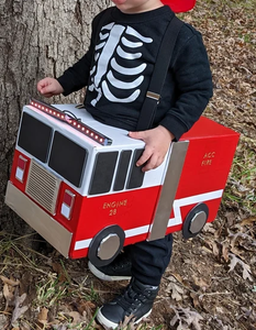

Most fire trucks have a yellow and red or white and red chevron pattern in the back. I didn't have yellow tape so I used white. Apply the strips of tape at about a 45% angle, or just estimate and space them out evenly. There will be a wide piece covering the center so the stripes don't have to line up perfectly at the center. Cut any tape that hangs over the side to line up with the vertical edge of the box.
Cut a piece of foamboard in the dimensions shown in the figure. Wrap the bottom half of the "T" with aluminum foil and secure with scotch tape. Use hot glue to secure this piece to the box.
The rear lights are actually from a LED shower curtain ring light set I found at 5 Below. However, when I glued them to the truck, they didn't light up. It's ok, they still looked great! Find something similar and secure with hot glue, or other glue since the heat may have been what caused mine to fail.
Apply gold letter stickers to sides of truck to customize your truck.
