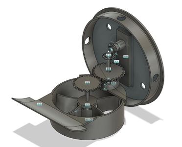

The first photo used here is a render of the 3d model on fusion 360. You can find the model at: https://a360.co/3X2vJom

Step 1: 3D Design Adjustments
First, measure the diameter of the knob on your potentiometer (this is for volume adjustment) and the dimensions of your toggle switch(the on/off switch), using a vernier caliper. Depending on the size of your potentiometer and toggle switch, adjust the size of the holes on the lid of the product in Autodesk Fusion 360, the 3d modelling software.
The link for the 3d model on fusion 360 is https://a360.co/3X2vJom

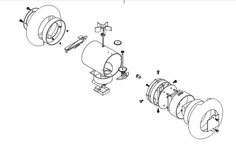

Step 5: Making the Lids (optional)
Note: this can all be 3d printed instead if you do not have access to acrylic sheet or a laser cutter.
There are lids either side of the product; one for the food compartment and one for the PCB housing. These are both made from laser-cut acrylic. The two opposite faces of each lid should be converted to whatever file format you use for your CNC laser cutter. I find it useful to first export the projection of each face to adobe illustrator before saving as a different file type.
After this, cut each face out of acrylic. As each lid is made of two separate pieces, these can then be re-attached using epoxy resin, or other adhesives which you have available, such as cyano acrylonitrile or hot glue. Remember to wear gloves to prevent sticking your fingers together.
Step 6: 3D Printing
For all the rest of the parts (apart from the nuts, bolts and bearings), we will use 3d printing. At this point, if you have skipped the metal and acrylic fabrication, you can also 3d print these parts.
The link to the 3d design is https://a360.co/3X2vJom. From this, you can pick out the parts you have not yet made and 3d print them.
note: I recommend using a very low infill density of ~25% on the rings that surround the product, as these can be rather expensive and heavy if made very dense.
Step 7: Ensuring Food Safety
Before assembly, it is important to use the food grade epoxy or polyurethane resin to coat the interior of the food compartment and the various parts of the food dispensing mechanism that will touch the food. If you do not have access to this, then cling film may be used to coat the interior every time it is used.
-It is very important to follow this step as FDM printed parts are prone to being infested with bacteria, due to the porous surfaces, even if you use a food safe filament such as PLA.
Step 8: Assembly
For assembly, I used the 3d model and sketches as a guide for assembly of the complete design. Most of the connections are made with adhesives, (I used cyano acrylonitrile - superglue - for small connections and hot glue for connections with a higher surface area) however the bearings and gear shafts should be push to fit. Connect small parts together first, such as the dispenser mechanism. You can then combine all the sub-assemblies. I worked on the PCB storage and food compartment separately, before connecting the two halves with the m4 nuts and bolts.
Note: be very careful when glueing the gear shafts to the bearings, as they are easily jammed.
Extra note: I would recommend glueing in the motor last, as the placement of this is paramount to the gear train. You can fix it temporarily in place with blu tack to test if the placement is correct, before permanently glueing in place.
Another extra note: Remember to place one or two small pieces of scrap metal such as screws or nuts into the motion detection chamber before completing it by glueing on the plastic rim to connect the two circular faces.
