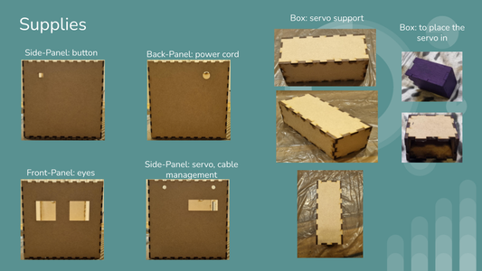

  • The second image shows a corner support used to connect two components. While this is one way to achieve the connection, it's not the only method. There are other components available that can accomplish the same goal.
I initially cut the right pieces from the wooden plank on a laser cut machine. It doesn't have to be cut by a laser cut machine so any other way is also possible

Step 4: Laser Cut
After successfully testing the proof of concept, I proceeded to create the design using wooden planks. I used laser cutting to ensure precise dimensions and shapes for the design. Additionally, I incorporated holes in strategic locations for efficient cable management
Step 5: Building the Design Part 1: Case
I began assembling the design to get a quick preview of where I would place the Arduino and breadboard. Despite having a sketch of the design, I wanted to confirm the placement to ensure everything fit perfectly.
