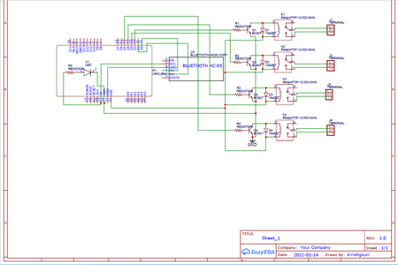

Step 2: Designing of Schematic Diagram
Designing or creating is a significant and crucial step as without it, we cant proceed further to make the Pcb Shield.
For designing the schematic Diagram, I used EasyEda software.
Of Course, there were many challenges, and it took time to fix them; as In the beginning, I was facing issues related to the size of components, but finally, I was able to get the result I wanted.
I am linking the pdf file for the schematic below.
Note: In Schematic Diagram and the Pcb shield, I have already connected the Tx of hc05 header pin to RX of Arduino and Rx of hc05 to tx of Ardunio. So you need to place or connect the Hc05 module directly
Lets move on further

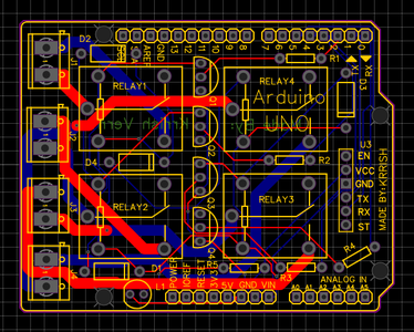

Step 3: Converting the Schematic Design to Pcb
We are done with the schematic right now, so the PCB board layout must be created to turn the design into an actual PCB later on.
EasyEda has a feature to convert the schematic to the Pcb layout. I used that feature to create Pcb Design.
It was challenging for me initially as I was facing difficulty putting all the components in such a tight space, so I had to resize the board a bit. Change the positions of the components a million times to get things right.
The next channel was to route the track. I used the autoroute feature for that, but I also had to change things manually many times. You can either manually route or go with the autoroute function.
But finally, after sleepless nights, I managed to get everything together perfectly.
Well, I know you want to do this project. So I am linking the Gerber file for this project so you can order the PCB using that file
Here Is The Google Drive Link For Gerber File Gerber File
