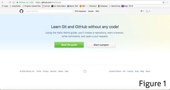

If you just created your account, click on the "Start a project" button, shown in figure 2, to start your first project. If you need to verify your email address (GitHub will tell you), do so now.

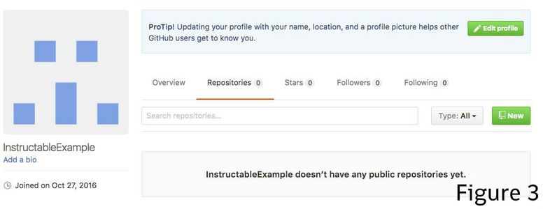

If you already have an account or was directed to the main profile page, click on the "new" button as shown in figure 3.

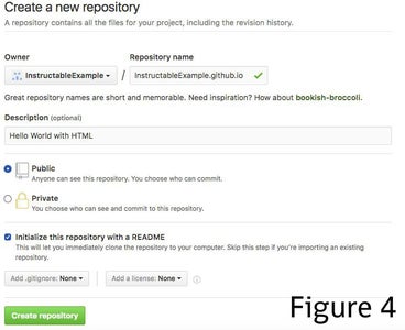

You should now be on a page titled "Create a new repository." In the repository name text field, enter your GitHub username EXACTLY as it is, and then place ".github.io" immediately after it. So if your username is Peanuts, your repository name will look like Peanuts.github.io.
The details field is optional, but is handy to keep track of your repositories.
A README.md is also optional, but these are good to have in case anybody is visiting your repository. The README.md is where they will find your notes on the project.
Even though it is optional, for this project you want to include the README.md. This is because if you do not include it, GitHub will not initialize your repository, which means you have to do it manually initialize it through the GitHub application that you can download or on the command line.
If you wish to go this route there are instructions here for using the command line to initialize a repository. Pair the tutorial with the instructions given on GitHub and it should be simple to do. http://bit.ly/17If11u
Before you select "Create your repository" compare it to figure 4 and make sure everything is correct. If you have already created the repository and found out you set it up wrong, that's OK, just repeat this step.

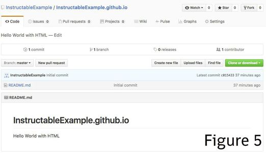

Now that you have created your repository, you should be redirected to your repository home page, where you can see all of the changes, files, and folders for your project.
If you included the README.md, your browser should look like figure 5.

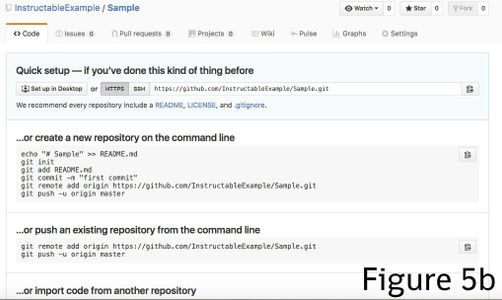

If you chose to not include the README.md and initialize your repository manually, your browser should look like figure 5b. Use the tutorial given on the last step, paired with the GitHub instructions, to initialize the repository.
If you did not want to initialize your repository manually, but forgot to include the README.md and your browser looks like figure 5b, go to the settings tab and scroll down to delete this repository. Once deleted, go back a step and create the repository again.

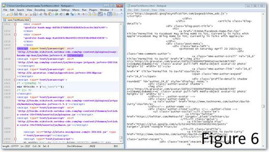

If you prefer a formatted text editor over the non-formatted defaults, you can download Atom for Mac and Notepad++ for Windows. There are many others available to you, but these are both free and easy to use. Figure 6 shows why it would be useful to use one of the formatted text editors over the defaults. It is clearly designed to show HTML code in an easy to read manner.

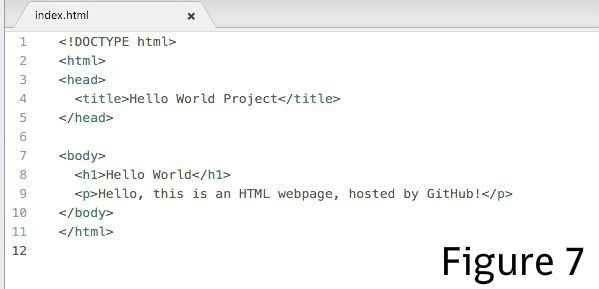

Look at figure 7 for an example of a basic HTML file and copy it into your file. You may change the data values to be whatever you want, but leave the tags the same.
Each of these tags explained:
- The "< !DOCTYPE html >" tag means that this document is in HTML.
- The "< html >" tag means everything contained within the opening and closing tag is in HTML.
- The "< head >" tag means everything contained within the opening and closing tag is meta data for the website. This is typically not seen by the user. One exception of this is the "< title >" tag.
- The "< title >" tag means everything contained within the data will be displayed on the tab of the website.
- The "< body >" tag means that the data contained within the opening and closing tag is the visual page information. This is what you will see on your webpage when you load it.
- The "< h1 >" tag prints output to the screen as a header. There are 6 header tags, h1-h6, where h1 is the largest and h6 is the smallest.
- The "< p >" tag prints output to the screen as a paragraph. The output is formatted as plain text.

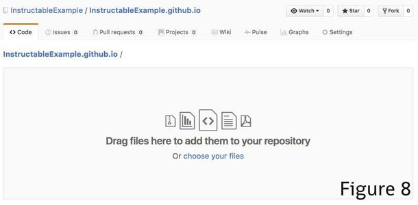

go back to your GitHub repository page and select the upload files button. If you cannot find it, make sure you are on your repository home page, as shown in figure 5 on step 2.
Once you click on the upload files button you will be redirected to a page that looks similar to figure 8.
Committing your file
This is the page where you will commit the files you want to change in the remote repository. Since we have added nothing to the repository, we will be committing a new file. Go ahead and drag index.html into the appropriate field, or you can choose to click on the choose your files option and select index.html.
After that, you will need to fill out a commit message, this should be a simple message reflecting the changes being made. For example, "Adding index.html" is appropriate. You will want to leave the commit to master option checked, and then select commit changes.

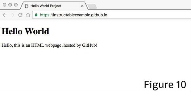

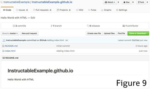

Your browser should now look like figure 9. This is the repository home page showing all of the files in the repository. Your website is now ready for viewing! Open up a new tab and go to yourGitHubUsername.github.io where yourGitHubUsername is the username you chose for yourself when creating your GitHub account.
If you followed all steps correctly, your website should look something similar to figure 10.
