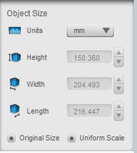

- Import the mask .obj file into the Autodesk 123D Make App.
- Set a new customized material for your MDF sheets that measures 20” x 12” x 0.100”.
- Select “mm” as the object units.
- Click on the “Original Size” option.
- Select “Stacked Slices” as the “Construction Technique”.
- Set “Automatic Dowels” with Round Shape and 3mm diameter (approximately).
- Set the “Slice Direction” horizontal, parallel to the flat back of the mask model.

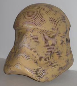

- Once you get all the slices cut, it will be time to assemble the whole model.
- Follow the assembly steps defined by the “Autodesk 123D Make” App. In this case you will start with the slice # 1, add glue to the upper face of this slice and then assemble the slice # 2 on top of it, continue this same process until you have enough slices to keep the dowels (Bamboo Skewers) in vertical position. Continue this process following the assembly steps until All the slices get assembled. Let the glue dry over one night. The final model should look like the image attached.
- Using a putty knife, spread the wood filler all over the model filling and smoothing the model surface to eliminate “step like” finish. Let the filler dry according to the instructions for the specific wood filler you use.
- Sandpaper the model surface, starting with a “Coarse” grade as 40, followed with a “Medium” as 100, and finishing with a “Fine” grade as 150. The resulting model after sanding is shown in the photo attached.
