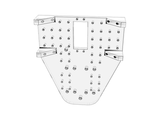

QTY 1 Base Plate

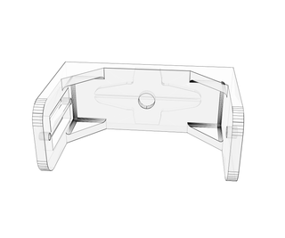

QTY 1 Camera Pan Bracket

To begin, you'll need to remove the support material in the camera pan bracket. The pocket for the servo horn and the center mounting hole will have support in them, so drill out the hole and clip away the center line supports. It doesn't have to be perfect, but it does need to be cleared enough for the larger servo horn to fit. Once the support is cleared away, use hot glue to mount the servo horn, making sure to keep any glue out of the splined center hole.
Take the small standard servo and insert it into the square cutout in the camera pan bracket. Screw it in with at least one of the mounting holes. The servo hub should be positioned so that it is furthest away from the bottom of the bracket (check the exploded view).
Next, Insert the Fatshark Camera module into the camera tilt mount. Make sure that the camera is oriented correctly, when looking at the rear of the camera module, the text should be facing upwards when the cutout for the tilt servo horn is on the right hand side. Insert the camera module into the stepped down area and zip tie it into place with two straps (one on each side of the lense).
Then, insert the servo horn for the smaller servo into the camera tilt mount using hot glue. Make sure to not get any glue into the splined hole where the horn attaches to the servo or you won't be able to mount it to the servo correctly.
Take the (camera) + (camera mount) + (servo horn) sub assembly and attach it to the small servo (which should already be installed into the pan bracket). Insert a screw through the hole in the pan bracket and screw it into the hole in the camera tilt mount.

This is exactly what the title of this step says...assemble the frame. This is where you fasten the continuous rotation servos and the camera gimbal into the frame.
The continuous rotation servos should fit right into the brackets that are printed with the base plate. Install them with the servo shaft closer to the front of the robot (the wires of the servos should be coming out this side as well). Screw the servos in with at least two small screws each (optionally, use all four screw holes that the servos and brackets have available).
Installing the camera gimbal is much the same. With the servo shaft and wire facing the front of the robot, put the standard servo into the rectangular cutout for it. The mounting bracket of this servo should be on the underside of the frame, the same side as the drive servos. Again, screw in with two to four screws.
