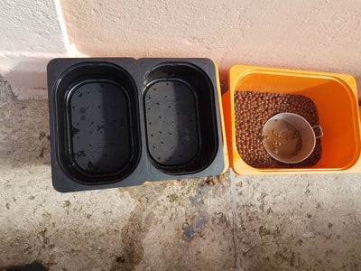

Step 2: Build a DWC System (Ikea Hack)
If you like to see the whole I'ble about building such a DWC, please visit the project of rfernandes18
I have made minor changes to this project. Frankly speaking I hardly claim any major improvements...
I just had a line on the side to be able to see the min level of nutrient solution (min level is for me the level when the water just touches the containers)
Some lessons learned so far:
  • After cleaning your clay granulates, especially if you had them one or two days in the water, small diameters segregates from others diameters. So take care to have all diameters in your containers when filling them up.
  • Take extreme care when moving your plants from their germinating medium to the clay granulate. I might have been not soft enough
  • I have used plants with 4 leaves. I think that it might be a good idea to wait a bit more as, a couple of hours after moving, they seems very weak.
I have planted 2 lamb's lettuces on each side.
At that point, I still had two major questions/issues:
  • Do we need the water to be in contact with the containers?
  • Do we absolutely need an air stone?
I have some answers to those questions (see next steps) but if you have any ideas/answers, please let me know.

Step 4: First Results: Difficult Start But Encouraging Facts
Three weeks later, my 4 lettuces are alive which is already a result in comparison to my wick system...
Really early in the project I have realized that my production of worm tea will be too small to feed all my projects. So i decided for this first round of experimentations about hydroponics to go back to a standard fertilizer. I have used a Bio Nova Hydro SuperMix, which is according to my local grow shop, very simple to use (I check that), very stable in water and powerful. I don't really manage pH and EC of the nutrient solution. I change water every 3 weeks as stated in the "Hydroponics for everybody" book. I don't supercharge my solution. I just use the lower level of fertilizer.
Next time I plant something in hydroponics I will use net pots. They are a much more convenient way to place correctly the roots without damaging them. They are super fragile and so important. I think I have not been careful enough so my lettuces have had a difficult start. But now they are doing better.
After a lot of thinking and reading I decided to buy a basic air pump. Oxygenating the roots seems to be one of the top way to ensure a sustainable growth of the plants. As I don't have electricity on my balcony, I plug the pump everyday for two or three hours through an open window.
If my plants are today smaller, with less leaves than their fellows grown in earth, I know that I am doing well with this wonderful design. I can see healthy roots reaching the surface of the solution. that's great.

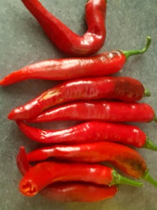

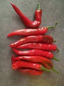

Step 8: July Update: First Harvest
Here are the pics of our first harvest.
Tasty!!!
