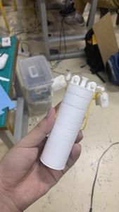

Step 2: Main Chassis
First, print the body provided in final applicator body.stl using PLA filament. I suggest using 0.8 mm nozzles to make the process faster, although I would not recommend speeding up the print through the nozzle speed at it may come out with defects like what you can see here.
Note: Earlier revisions of this design featured a much larger body than the final product. I would recommend using the larger body, however personally I didn't find the smaller body any less convenient.

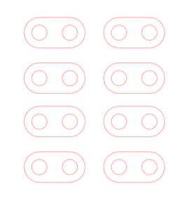

Step 3: Joints
Using a laser cutter, cut out the figures provided in joints.pdf. This allows the receptacles to articulate well with the main chassis and the connecting rods.
Note: I suggest if you're printing the larger one, to make sure to print extra joints and connecting rods. Two sets should be enough for the larger set-up, however.

Step 8: Usage
To use the device, place a contact lens on the inverted dome. Then, close the receptacles together. Close your eyes. Put the receptacles up to your eyelids. Release them when they're secure on your face. Then, push in until you can feel the contact lens on your eye. I highly recommend dousing the contact lens with the prescribed lubricant of your choice before application.
