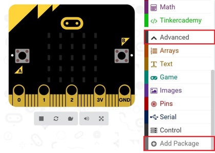

Step 6: ​Pre-coding
We will add a package of code to enable us to use our kit components. Click on Advanced in the Code Drawer to see more code section and look at the bottom of the Code Drawer for Add Package.
Step 7: Add Package
This will open up a dialog box. Copy and paste the following link into the Add Package… text field: https://pxt.microbit.org/50544-64675-33322-24641. Click on the search icon or press enter, then click on the Tinkercademy button.
