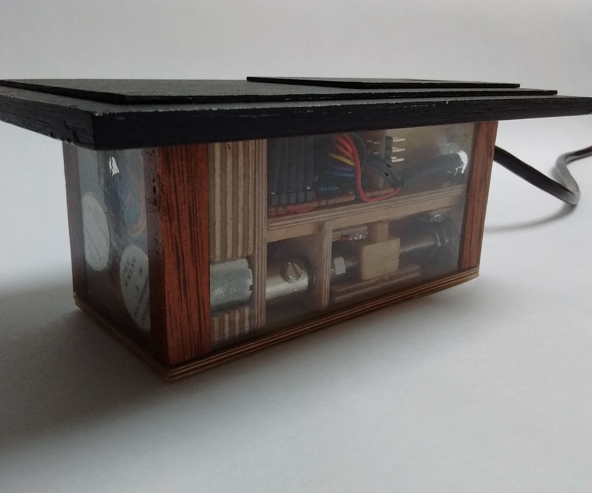

"What a boring black box"
Yes it is, but:
– It feeds my fish when I'm not there.
– It feeds at a predefined time.

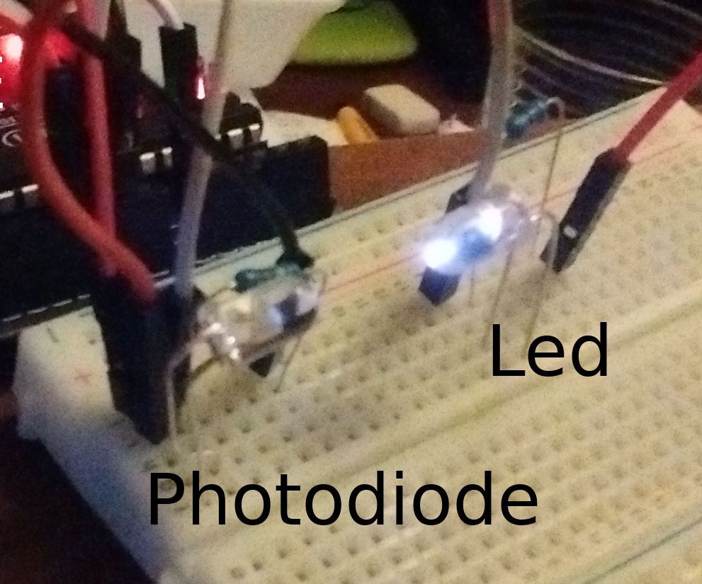

– It senses the food given to the fish
– You can login remotely into the raspberry pi to see the status.
– It can send an e-mail when something is wrong.

- The build of the sensor

The build of the sensor can be found here:
https://www.instructables.com/id/Fish-Feeder-Sensor-Array/

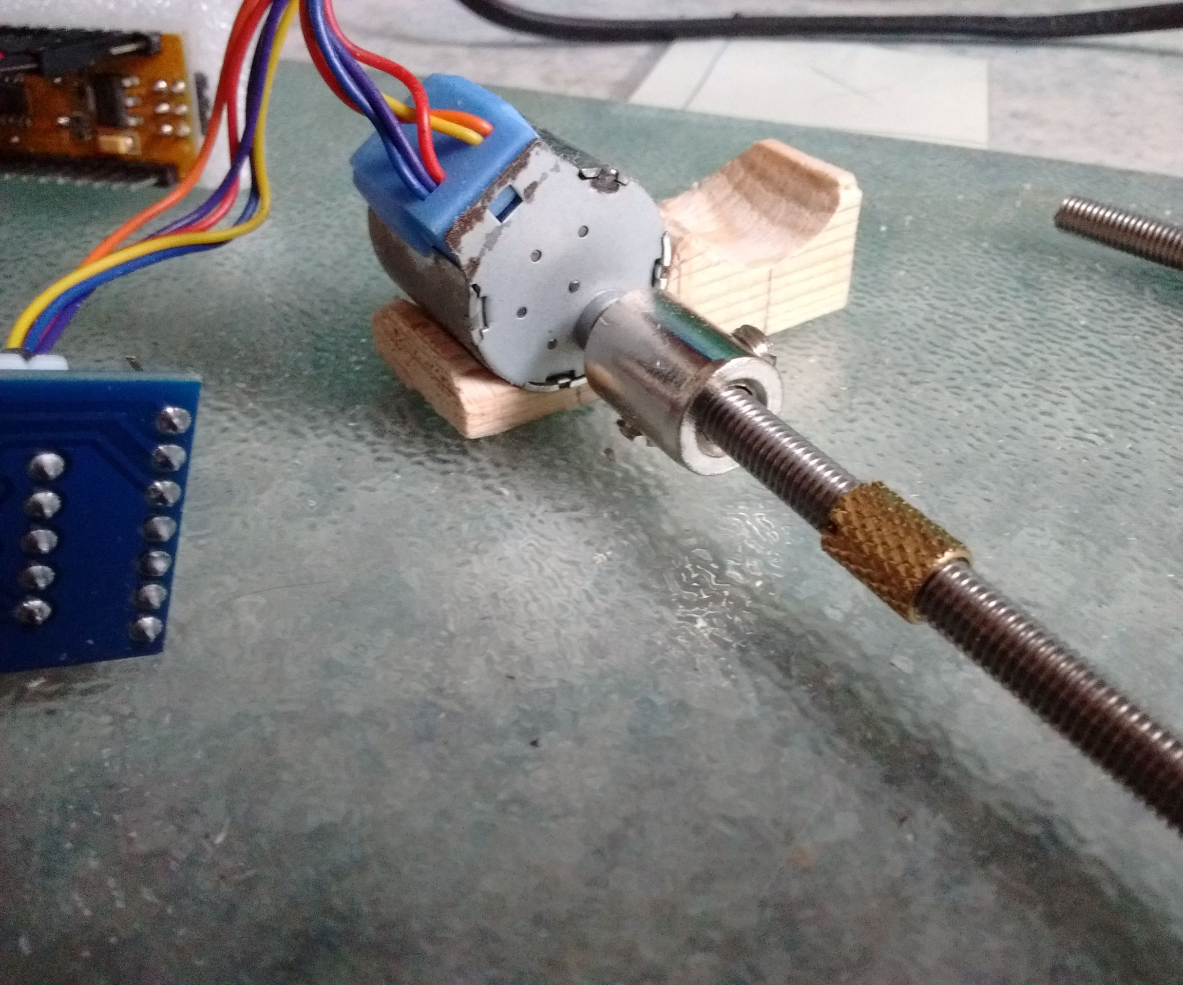

FishFeeder
The FishFeeder is the machine that delivers food into the aquarium. It is controlled by the Arduino. The Arduino is instructed by the Raspberry PI. The build of the FishFeeder is documented see links in STEP1.
