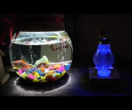

Introduction: Fish Feeder Using Arduino Nano, Servo Motor and Waste Materials
It is a simple project by using a single servo motor and few basic materials.
It helps to feed the fish timely.
