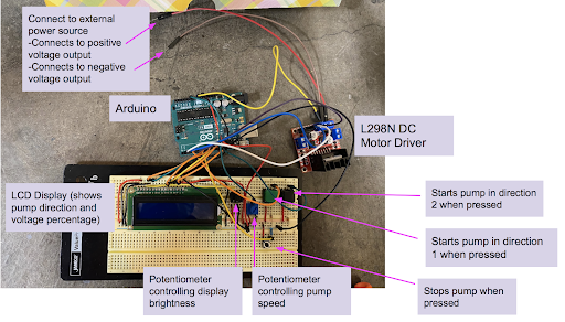

Step 3: Build Pump Control System
Materials/Components:
- 3 220 resistors
- L298N motor driver
- Arduino Uno
- 3 push buttons
- 2 potentiometers
- LCD module
- breadboard
- USB cord for Arduino
- Wires
- External Power Source (12 volt supply source)
- 12 volt pump
Step 1: Assemble the circuit as shown in the diagram
Diagram Key:
A. Potentiometer controlling LCD screen brightness
B. Potentiometer controlling voltage setting (duty cycle percentage)
C. Push buttons that start pump (one for each pump direction)
D. Motor driver
E. Arduino
Step 2: Solder wires on the positive and negative terminals of the pump, making sure wires are long enough to extend from pump to the motor driver
Step 3: Attach pump to motor driver by screwing the wires from the pump into the “Out 1” and “Out 2” ports of the the motor driver as indicated in the motor driver diagram
(Motor driver image from: https://components101.com/modules/l293n-motor-dri... )
Step 4: Use the USB cord cable to connect the Arduino to laptop
Step 5: Download Arduino code and upload to Arduino (after code downloaded keep Arduino connected to laptop to power the Arduino)
Step 6: Connect to external power supply
To connect to the external power supply, screw wires into the 12V and GND ports of the motor driver. Use Alligator clips to connect these wires to the positive and ground of the power supply. To prevent damage to the motor, turn on the power supply and set to 11 volts before connecting the power supply to the motor driver.

Step 4: Tank Operation
Step 1: To connect to tank, insert pump tubing into the holes cut out into tank front
Step 2: Start pump by pressing either button labeled as “C” in the first diagram or the green and black square buttons in the second diagram
Step 3: Adjust speed and screen brightness with the potentiometers
Step 4: Turn off with small black push button
