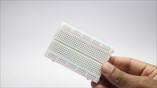

Breadboard small

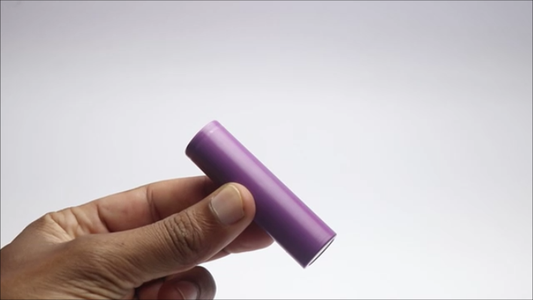

Lithium ion battery
Battery holder

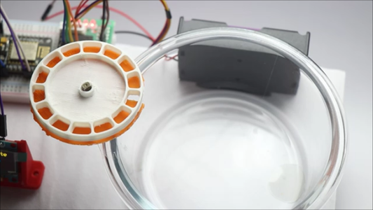

I will begin this project by printing the most important part that is called the dispenser, The design is simple but it serves most in our project
It is divided into 13 slots and each slot will fold specific amount of fish food, You can even use a bigger container upon this and increase the quantity and use this to feed other pets also.
I will use Cura slicer to slice the model, You can simply see the setting that i will be using, There is no need of any rafts or supports at the time of printing since we don't have any overhang parts.
Simply use the files that is given below, You can also modify the size but if you use the same stepper that I'm using no need of making any changes just use as it is.
Second part is the base for this slot part and that is just a plane circle part with one small slot.
I will use PLA filament to print the parts and the choice of filament color is left to you.
If you don't have a 3d printer you can download this model, mark up the measurement on a paper and later cut the same on a cardboard sheet.
This design will serve best for fish food dispensing since we only need small quantities of food that should go into the water or the fish consumption.

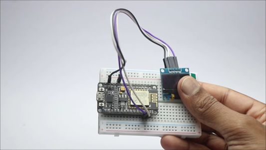

I will upload the program to the nodemcu first, to do this all you have to do is connect USB cable to computer first and the then to the nodemcu board.
Open Arduino IDE and paste the below given code, Now you should see a code in the code you need to replace the Wi-Fi credentials of mine with yours.
Open the port and select proper port type and now the proper board name, Click on upload and now the board is ready and we can head over to building the circuit connections.
You can also replace the use of breadboard with direct connections, But i recommend not to do so.
OLED module connections
VCC to 3.3V power rail on Esp8266
GND of OLED to GND
SCL to D5 (GPIO14) pin on board
SDA to D6 (GPIO12) on Nodemcu

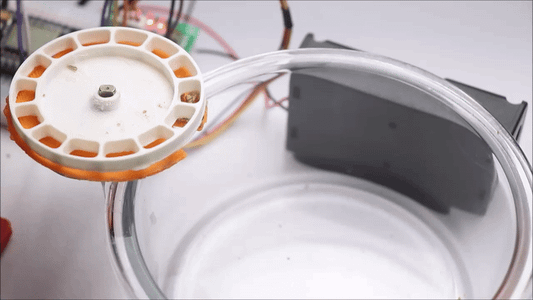

The base part needs to be glued first, Instead of using any screw type of fit that will take additional components i eliminated and replaced it with hot glue.
Pour some hot glue on the stepper motor surface and place the base plate and allow to dry completely.
Now we can add the top part(slider part) that moves and is connect to the stepper motor shaft, The design that i followed will allow stepper motor to be connected well to its shaft and does not need any glue or screws.
After this is complete we have the electromechanical components ready and pending thing is the base that will hold all of these components and a fish bowl and i will install ll these on them.
Refer to the last image of this step to see how i assembled all the components and the space management system.
Make sure that the jumper cables are away from the stepper motor mechanism part since if any overhangs are present, it may cause problems at the time of working and we are not expecting that.

Follow this simple instruction and your device will work without any issues, start by connection USB cable to nodemcu board and later connect external battery to the stepper motor.
Then open the wifi setting on your phone and you will see nodemcu connected to your device, You will see the OLED showing the connection status when board is power to on and when it is connected it will also display IP address.
Note that address and open any browser on your phone, Type the address and click on ok you will see a panel that will enable you to control the stepper.
Try sliding the switch to highest first, lowest next and in between to check the stepper response and you should see the stepper working fine without any lags.
Now the device is ready for using, Fill up the slots with fish food and repeat the same steps, Note that the stepper wont work without any additional battery.
